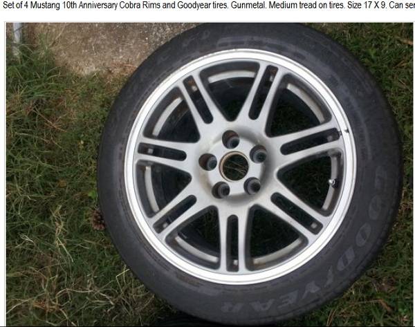

I'm gonna do a 4.5'' hub swap soon...how would these look on my Mark?

I bet these went quick
24mm offset 9" wide wheel is less than ideal fitment. They will protrude past he body lines a lot.
Even 26mm offset 17x9 wheels don't look right especially at regular ride height. I had some 03 Cobras machined to make them look better in the past.
It doesn't sound like a lot (36mm vs 24mm) but it does make a difference when on the car.
1/4 panel lips will interfere with almost any tire size, but it all depends on the rear shock choice as well. Will then tuck when lowered ? NO. Unless it's a 235/50 tire ... maybe.
Still a good price price for these wheels I guess. You can always machine then 4-5mm depending on the hub design.
Typo on the seller. The offset is +36, and not +24. Strange how nobody can find these wheels. The manufacturer Rev-Wheels has them, but will only sell to distributors, which is Supercoupe performance.
Consider yourself lucky.
