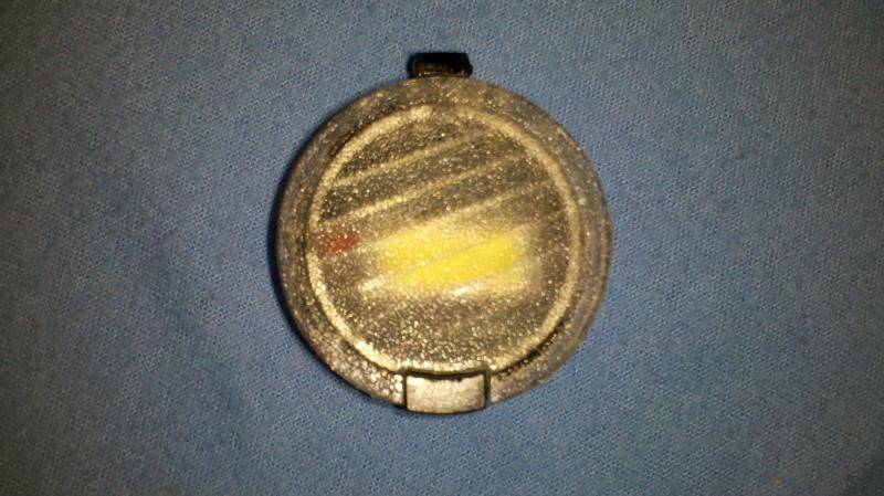

Puddle Lamp LED conversion

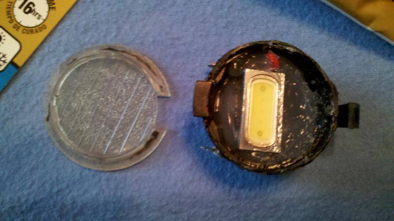

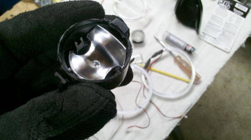

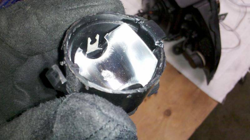

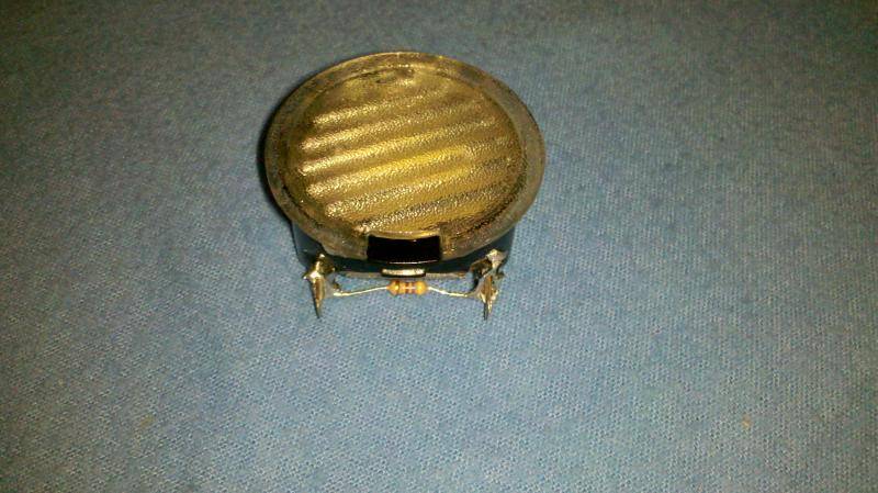

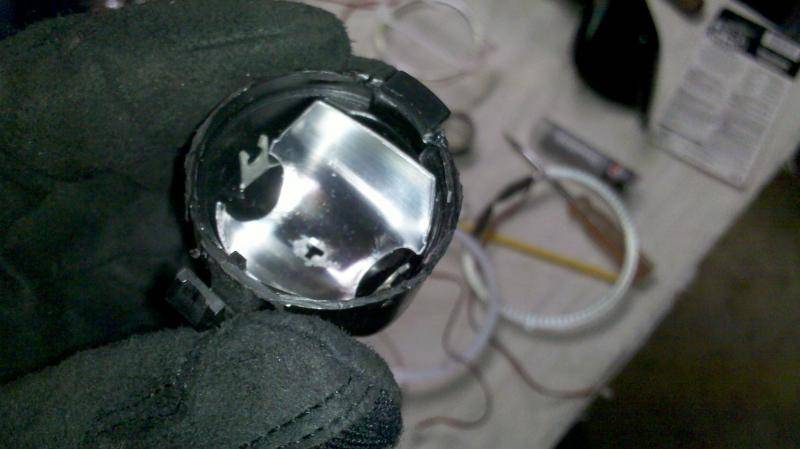

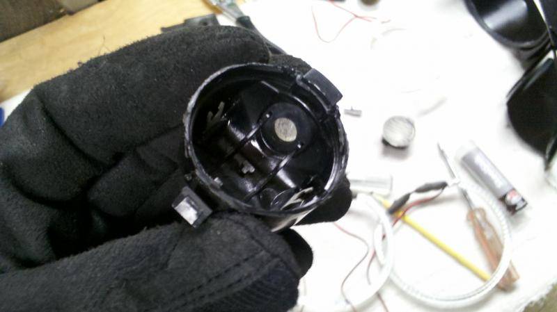

I took a different route with the puddle lamps. Instead of the festoon LED replacement with either 4 or 6 SMD LEDs...I went a little more permanent...and i think the light out put is at least 2x's as good.
I purchased the LEDs off ebay - see link - they are 2W a piece. I removed the reflector shield, wired the black and red leads to the connectors inside the housing with crimp on female connectors, and filled with silicone .
I will take some night pics soon, been busy with everything else, but here they are un-installed.
link to the LEDs - http://www.ebay.com/itm/120976552807?ssPageName=STRK:MEWAX:IT&_trksid=p3984.m1423.l2649
