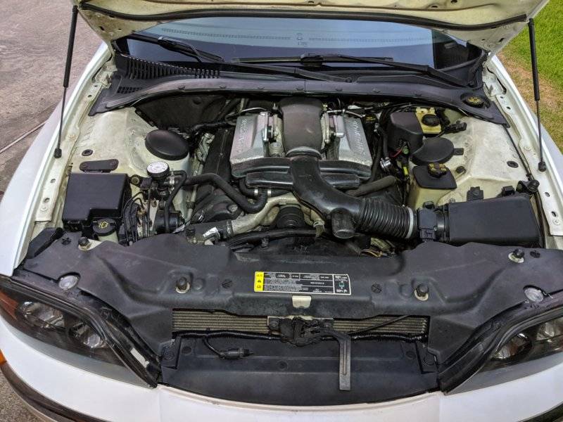

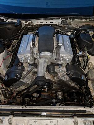

    It's been a while since I've posted.
    I am a tried and true Lincoln LS guy to the core!
    In 2015 I had a Lincoln LS crisis when my Lincoln left me completely stranded 330 miles from home.
    I came to my senses and completely tested my custom engine wiring harness.
    With the help of my younger brother, we discovered that the crank sensor wiring had a short.

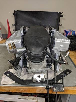

    Without further ado, here is my 2000 manual conversion Lincoln LS with a Jaguar STR supercharger!

      That's a beautiful work of art & science right there. Congratulations & much respect to all the work it took to actually go & do what many, MANY, people have talked & theorized about. About time somebody actually got around to doing something like this. Do the Lincoln World a favor & take as many pictures of this unicorn as you can. No telling how long it'll take before there's ever another one

      Very Nice! Difficulty of install 1-10?

      As the owner of a 2001 manual LS I would REALLY like to hear/see more about this. :)

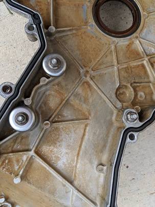

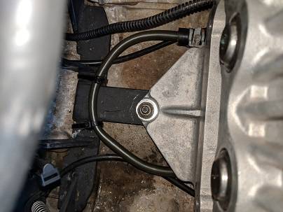

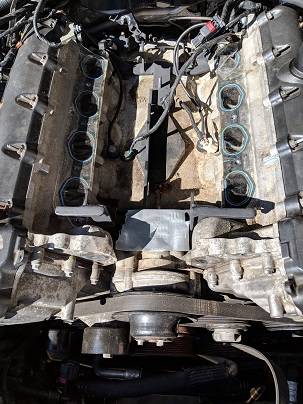

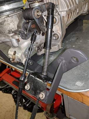

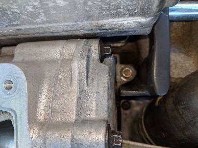

      Here are some of the build photos.
      • Like Like x 2

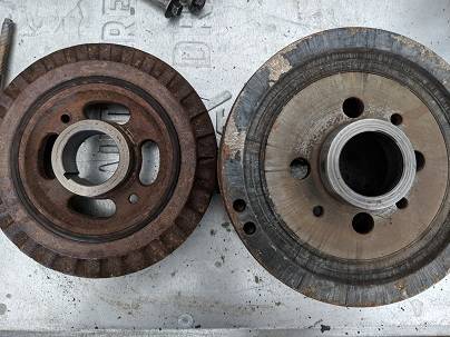

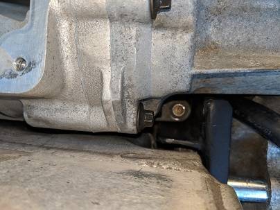

      • dwiggy
        dwiggy Active LVC Member
        Messages:
        183
        Likes Received:
        19
        Joined:
        Oct 10, 2011
        Location:
        Madisonville

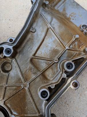

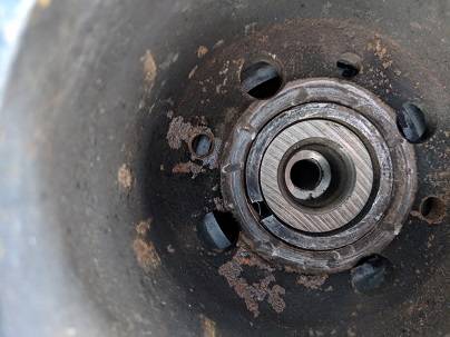

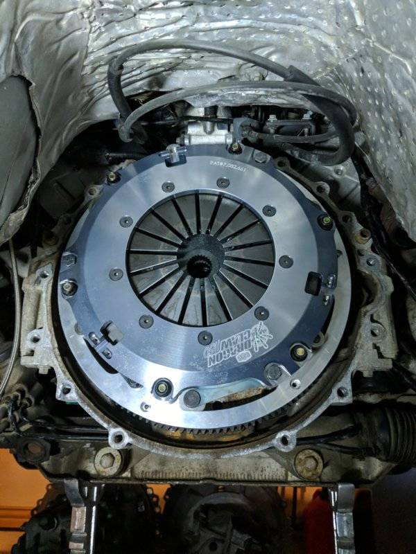

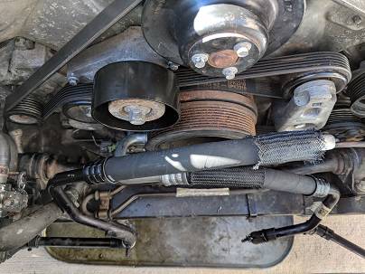

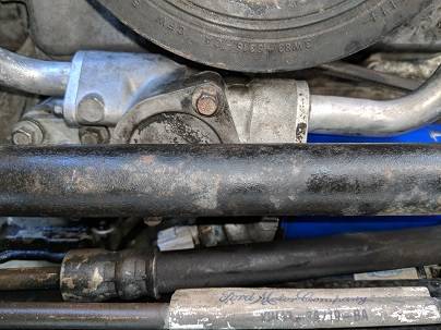

        … and two more.
        • Like Like x 2

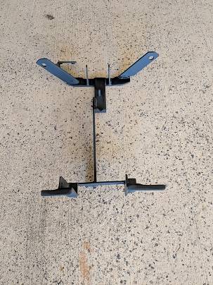

          Yes sir! I've posted some of the critical mod pictures.

          I built the black mounting bracket in the photos and mounted it to the AJ35 Lincoln engine.

          Looks OEM, doesn't it;).

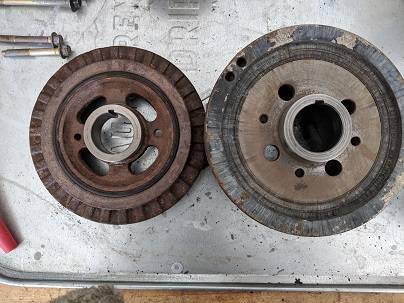

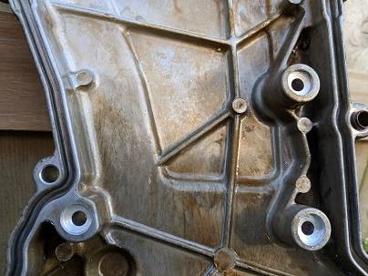

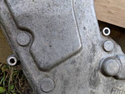

          Being a Gen 1 car... I assume you converted to solid cam gears and did away with the phasers?

          Yes. I used gen 1 intake cams and blocked the oil ports.

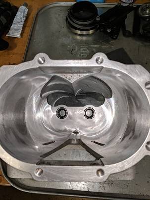

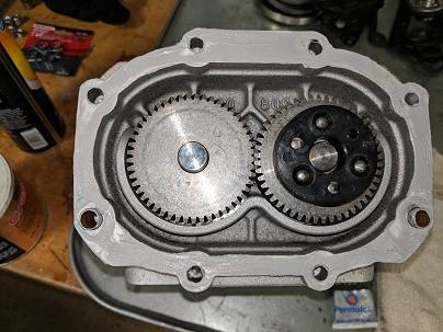

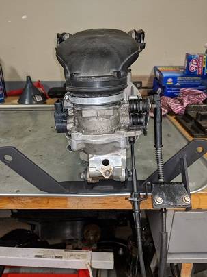

          Latest upgrade in the making. Full write up pending.
