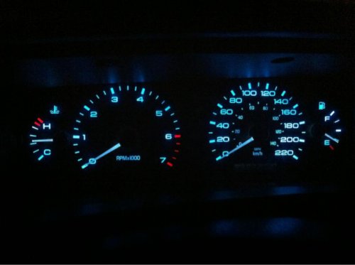

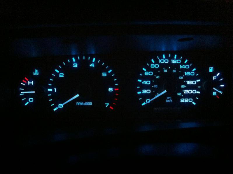

Here's the pics as mentioned. Really happy with the result!!
Here it is complete

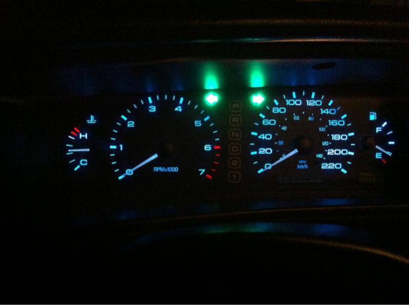

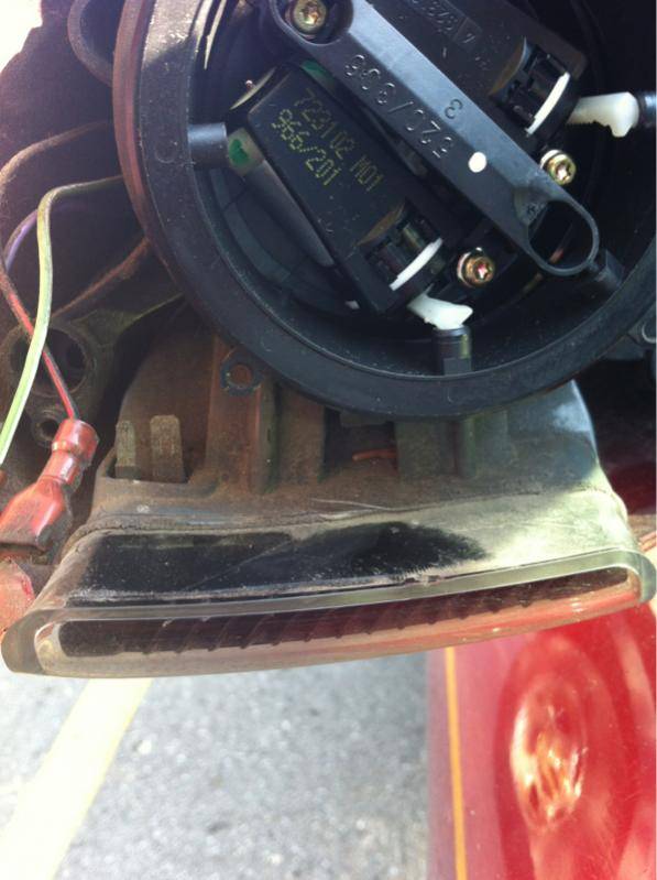

And the turn signals as well.
10 bulbs total so far, one for fuel gauge, 3 for speedometer, 3 for tachometer, one in each signal and one for temp gauge.
Need 7 more for the warning lights(ABS, ebrake, t/c, etc) in the instrument cluster and 8 more to do warning lights for info center(again t/c, abs, airbag,etc) thanks for checking in.

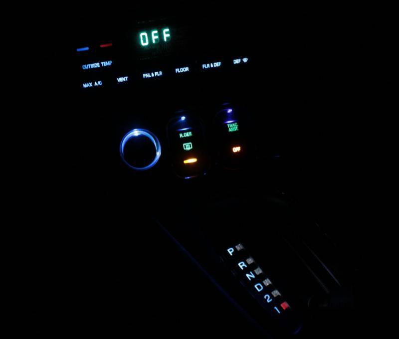

Here are some of my LED installations....

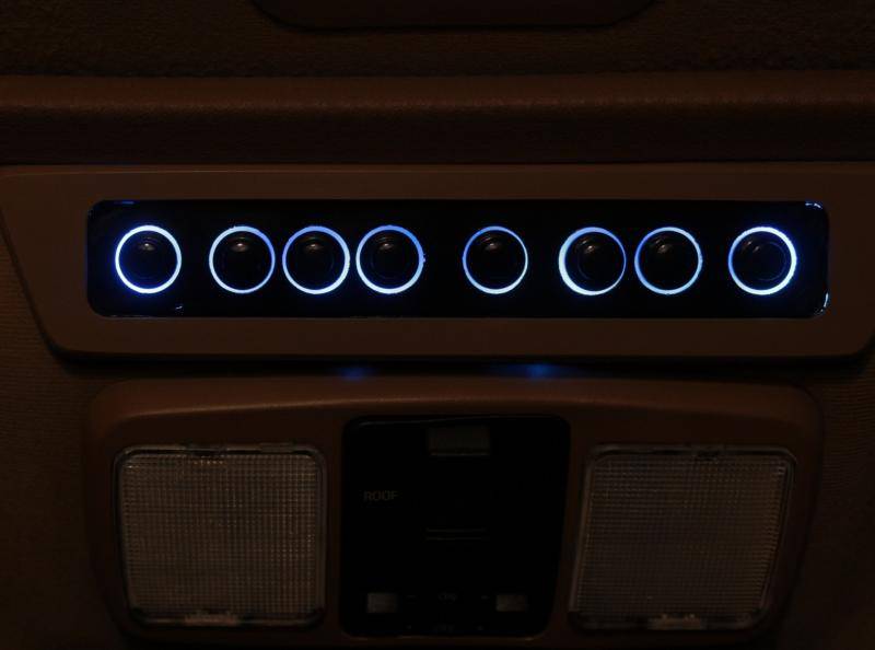

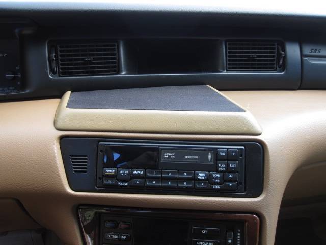

Relocated Info center buttons backlit by blue LEDs

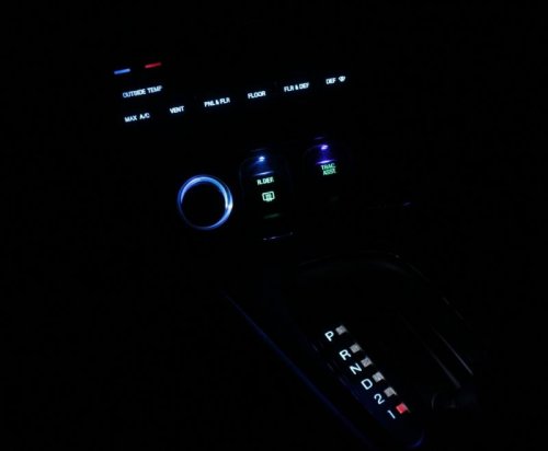

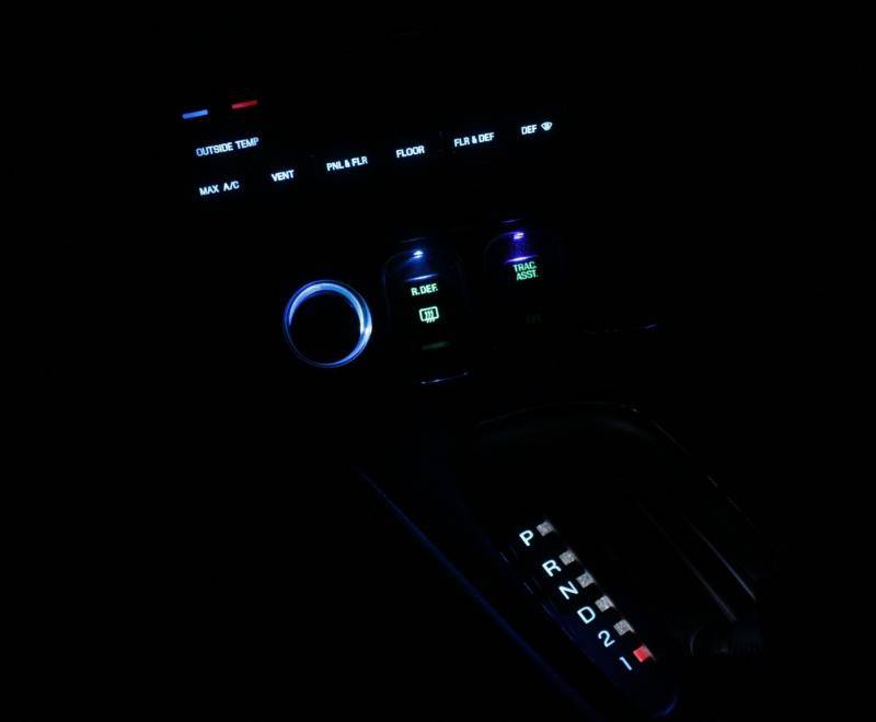

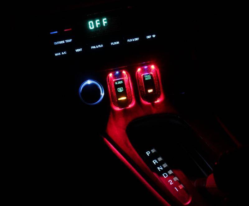

Center console light show upon startup. EATC buttons and Shifter Position received the white LED treatment. Because the factory silkscreening was done in blue so they shows up blue. Red LEDs are the Oil and Brake Status Indicators.
Flashing blue LED ring around the cig lighter is the Alarm Indicator.
On drive, a blue glow is cast in the cockpit area accented by the blue LED Info center switches from above and the subdued blue ring surrounding the cig lighter stays constant.

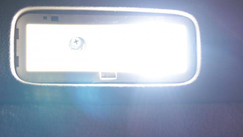

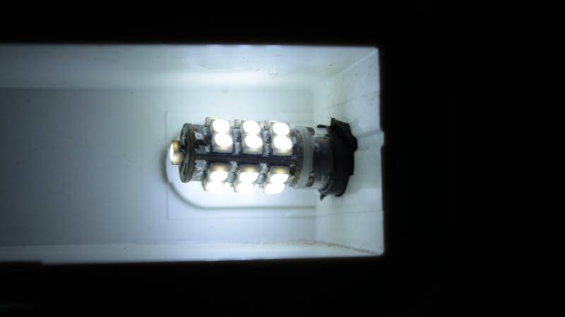

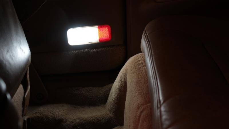

The doors got the SEM LED bulbs. These are the perfect brightness once the lenticular diffusers are in place.
25 LED SEM bulbs, 5000K
Looking at the passenger side door lights.
These upgrades were done six years ago. I would have thought these mods would be all too common by now.:shifty:;)

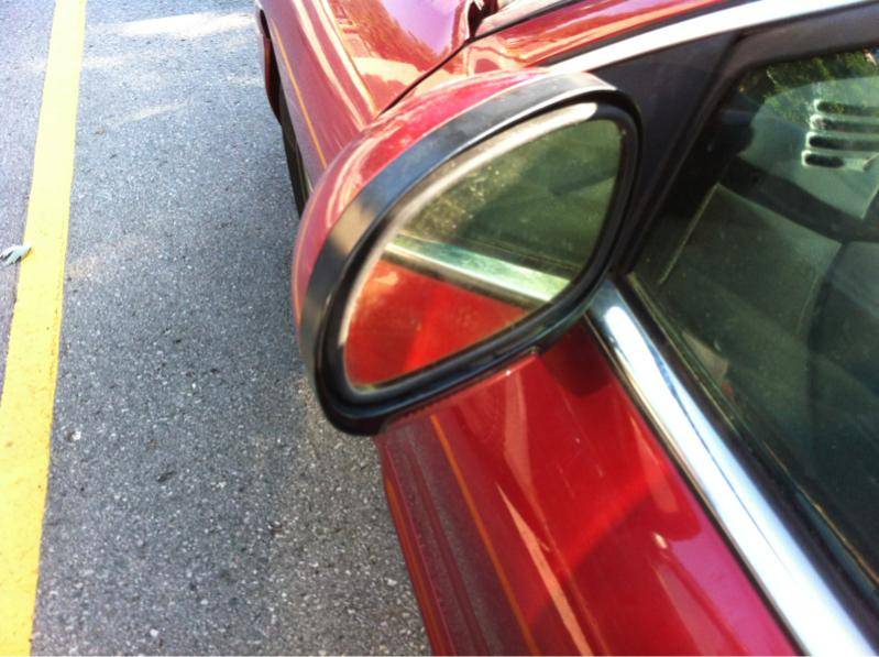

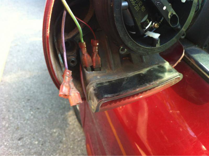

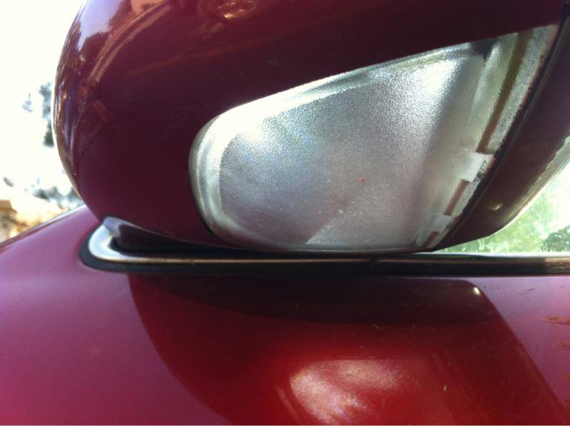

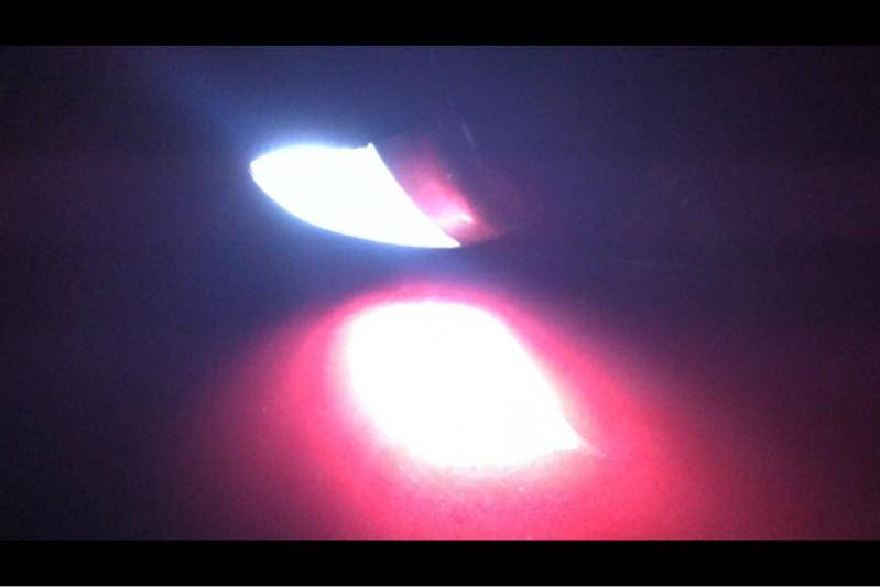

Well I got my puddle lights in so here's the install and day time pics. Will post night pics tonight

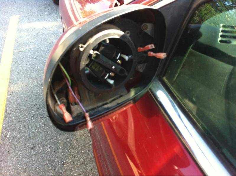

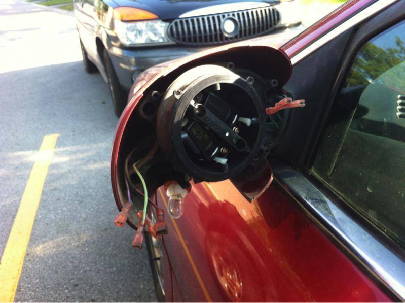

Remove mirror glass
Removed outer plastic bracket
Little clip to pull out the light housing

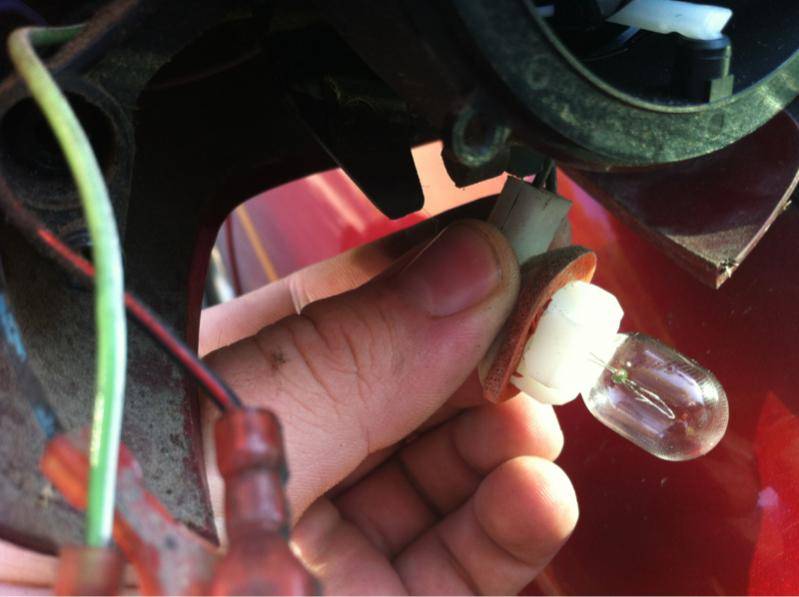

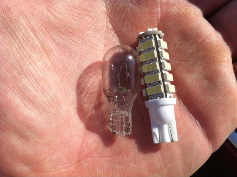

Removed bulb from housing
Original bulb and new led bulb.
Installed bulb and put everything back together. Here's the completed product in day light. As I said I'll post night pictures tonight. More to come soon!!
i need to mod a set of those mirrors onto a gen one so i can have a light to put an led in too :) try and get a picture the darkest part of the area. im curious how it looks on the ground
How the heck do you get inside the outside mirror to change those puddle lights? I always wondered about that?
How the heck do you get I side the outside mirror to change those puddle lights? I always wondered about that?
Mirror pops right off then the puddle light has a little clip holding it on, pull up this clip and slide the light housing out and tada there you go
What do you mean "pops off"? can you explain what you do to get it off, and any tools requiored to do the job. Thanks!
Honestly to get the mirror glass off I used my fingers and either side and pulled. It is surprisingly easy to get off it just clips on the the power mirror motor lol and even the light bulb housing I pulled the clip up with my one finger and slid the housing out with my other hand. But that I did after taking the plastic bracket piece off, which I needed a torxes bit to remove the 5-6 screws prior to removing the lightbulb housing. Any other questions ill gladly answer :-)

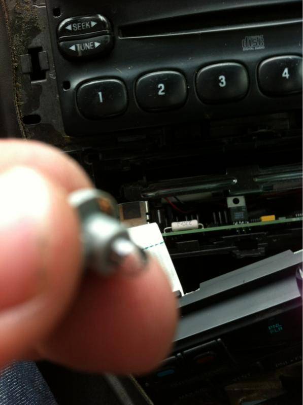

Have been looking at playing with the strange little bulbs in a few places (the wording for the buttons on the message center, the temperature control center and a few others for example). Have heard you need to solder a new blue led on the board but was curious if there is another way so as to avoid soldering? Any ideas and suggestions are welcomed and if anyone has done this would really like to see. Hopefully have all blue to match my dash.
These are the little lights I'm talking about
