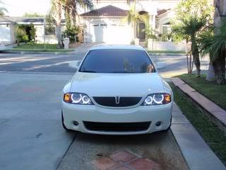

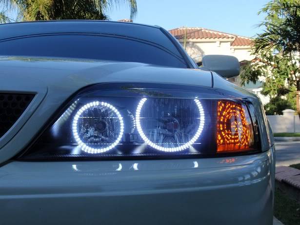

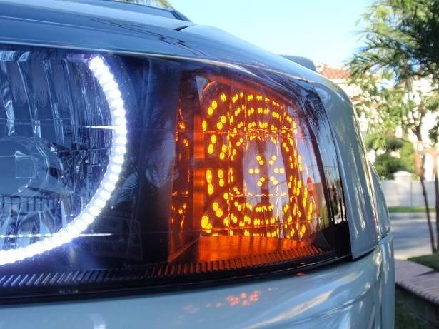

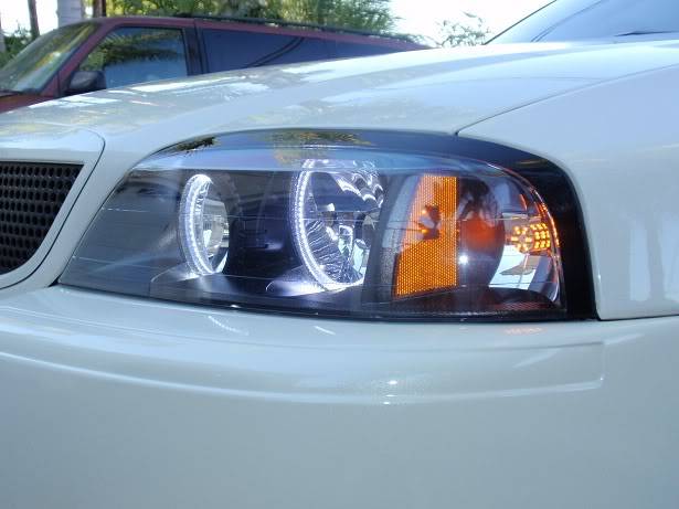

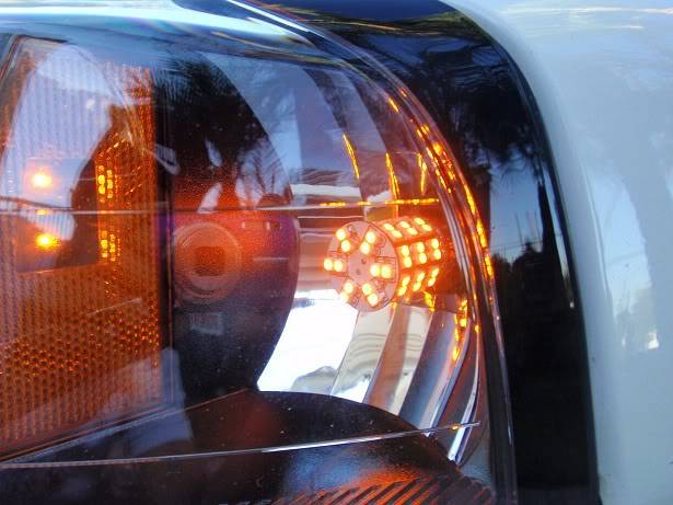

Here are some pics of the LED's on with the parking lights
I do have to say alax your LS is one of the best looking. nuthing but class.
Thanks guys. No I dont change the grilles daily, I just left the mclaren grille on there from the photoshoot.
Yeah that ls is beautiful.....looks like a beamer.
Well the lights will work, I just haven't figured out how to get the bulb out message to go away.
