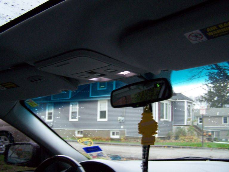

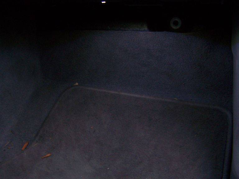

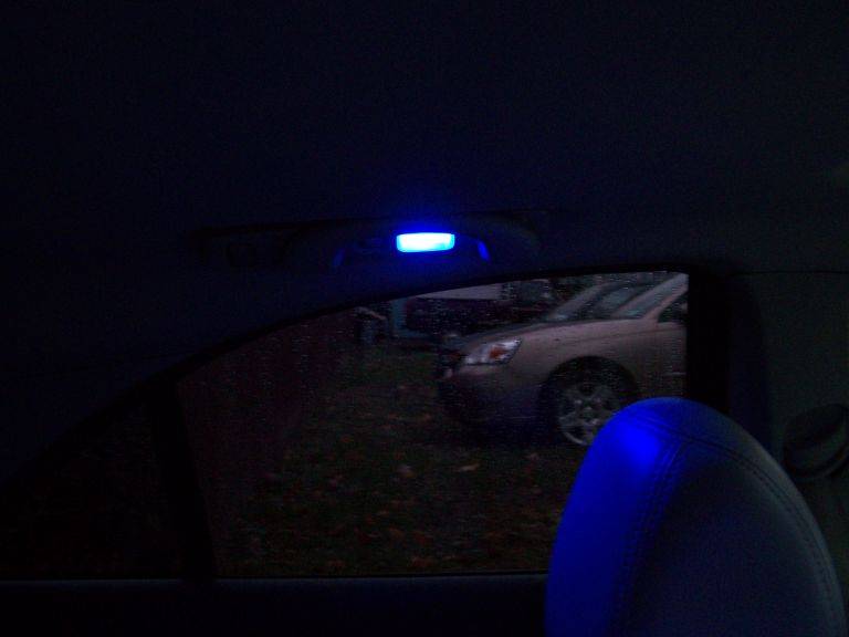

Also here is a few pictures of the new LED's sorry for the quality my camera didnt agree with out the flash

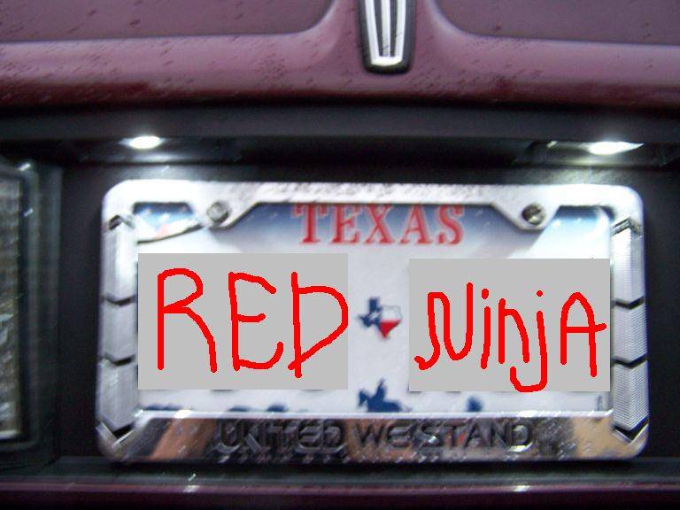

License Plate LED
I just finsihed the LED conversion of interior, puddle and license plate lights. I first ordered the "1 HID White High Power License Plate LED 194 168 158" as recommended in this thread. That bulb did not seat properly in the housing on a 2006 (too long and bottomed against the lens). I re-ordered the "HID White 4 M-SMT 2W High Power Bulbs 194 168 158" which are specifically designed for low clearance applications. These fit great with no need to modifly the OEM housing. The light outout is also great...only downside is they are a little pricey @ $19.99 for the pair
