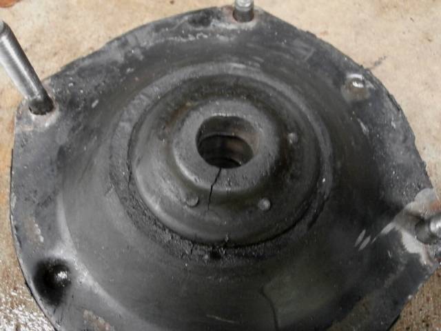

so I've been driving with my clunky rebuilt front end for a few weeks now, today I paid NTB to remove the coil over shocks and r/r the strut mounts (new KYB's);
instant fix, took it for a test drive and: no more clunky clunk :cool:
here's one of the old mounts, pretty sure it was the problem:
looks like I'm finally done putting time and money into rebuilding the front end
One of mine pulled the washer all the way through. I may need to double check it as I did put a brand new one of these on their. however never hurts to double check to make sure. glad you found your clunk.
it sux buying used parts that need replacing/repair: this strut mount was on the shocks-coils I bought from the guy in Waco a few months ago. He changed the coils from Vogs to Eibachs prior to shipping

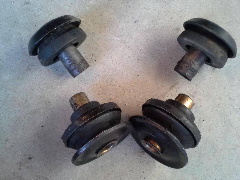

got some help diagnosing today...5k miles and 9 months ago I replaced everything on the front end EXCEPT the forward SRBs (at the K-frame)...and they are squeaking now- I can feel the cupped washer vibrate when someone pushes down/up on the fender. Which forward SRBs are good to use a replacement? I know the rear ones should be oem
As I said on Facebook, (for others reading this), the rear SRB's don't really NEED to be OEM. I've had good experiences with other aftermarket brands.
HOWEVER, the forward SRB's should definitely be the OEM style. They're the only ones that consistently last longer than 5-10k miles....

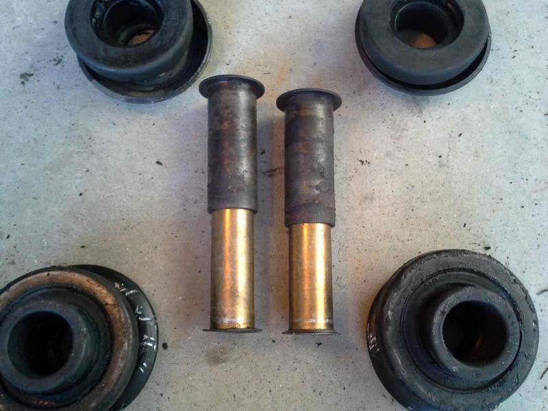

what's wrong with the metal sleeves that come with the Moog, Rayb, ACDelco or Duralost bushing kits?

removed
reusable!

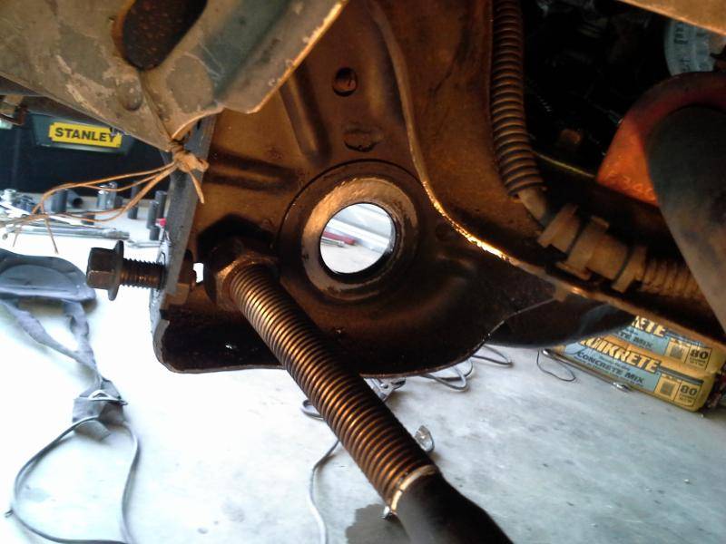

removing the forward SRBs I followed the service manual:
-back off inner retaining nut, which actually means turn clockwise?
-remove outer retaining nut
-remove lower shock bolt to LCA
-remove brake hose bracket from body
(now the manual says to remove the outer washer and bushing then 'pry' the strut rod through the frame)

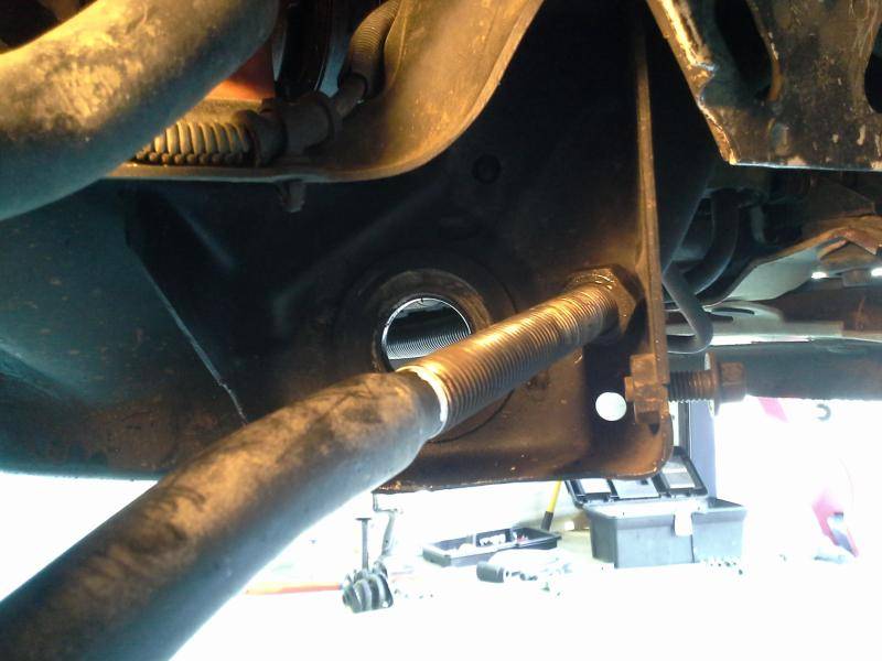

I couldn't pry the strut rod back through the subframe so I:
a)loosened/removed 3 shock tower bolts b)loosened LCA to frame camber bolt after marking ecc washer at frame for general realignment...c)loosened UCA to fender bolts d)loosened/removed UCA to spindle bolt
then I loosened (turned counterclockwise) the inner SR retaining nut so as to push against the SRB washer and eventually push the rod back through the bushings and frame, as pictured above
the LH side moves freely enough to do what I need to-install new bushings, but the RH side is pushed against the frame tighter than a dick's hat band! idk how I'm gonna get some play for that side...suggestions? I'm thinking maybe I need to remove the retaining nut from the strut rod to LCA, just behind the LBJ, maybe remove the camber bolt? maybe get a 2x4 cut to length and wedge it between the front of the subframe and the outer part of the LCA?
