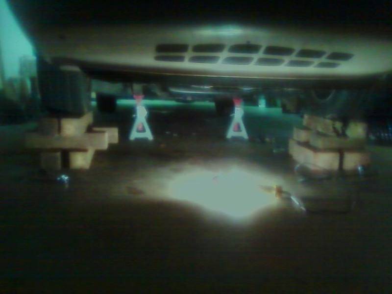

I had all fours off the ground, tried the jack stands under the lca but you just don't get the compression. I put the front tires back on and lowered it onto blocks which worked perfect. With the rear still off the ground and the car sitting pretty much level it was easy to get under it.

I see the jack stands but those blocks my friend.. One word... Scary
they don't look as scary in real life.....the jack stands are not making contact but I'll use those under the LCA's after I take the wheels off to fully torque the SRB's....I'll be glad to get this behind me. Seems like it's been forever to get it done
