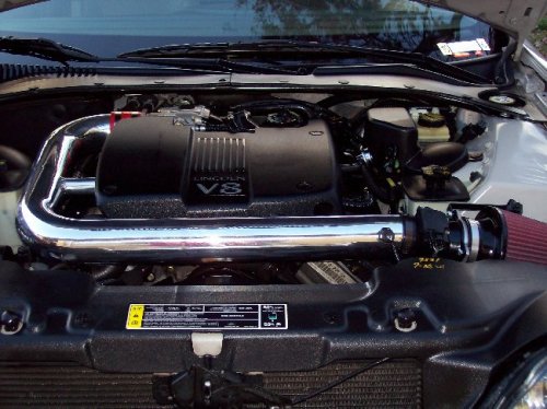

Ok, after lots of searching on here I'm confused. Can someone tell me what is the latest/greatest and most cost efficient aftermarket filter setup for a 01 ls.:confused:
You have the polished aluminum and stainless intake tube from LS Koncepts. Horsepower gain are the same. For the Filter setup you have KKM and K&N setups, difference in horsepower gain is minimal. There are a couple of other filters, but these two add the most. www.lskoncepts.com
Not sure if there is a K&N setup for 00-02 LS's, so the only options are KKM or custom.
There is not much to the KKM AT ALL. All you need is a billet aluminum MAFS filter adapter and a filter (brand of your choice), 4 small bolts and a MAFS gasket and you have all the parts KKM will give you. By scraping all the parts together yourself you can save around $25-$50 depending on which brand of filter you go with. It is a really simple process. By the way do not get any of that Auto Zone plastic MAFS adapter crap as it is just cheap garbage.

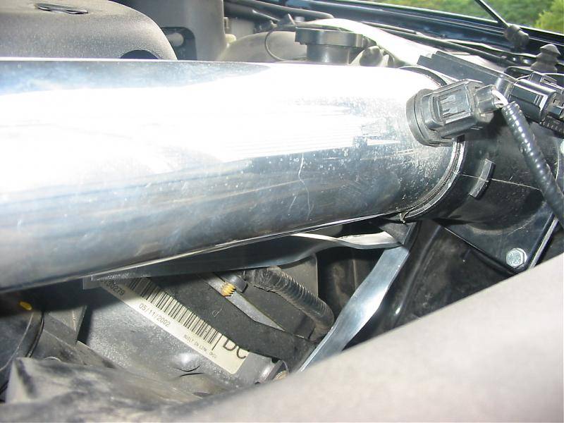

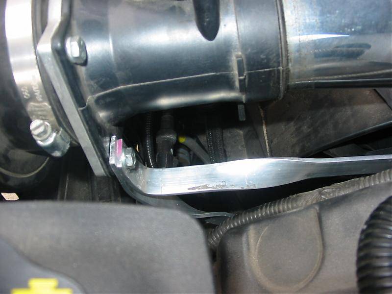

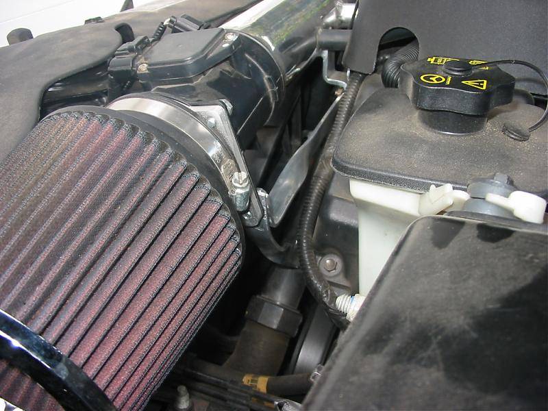

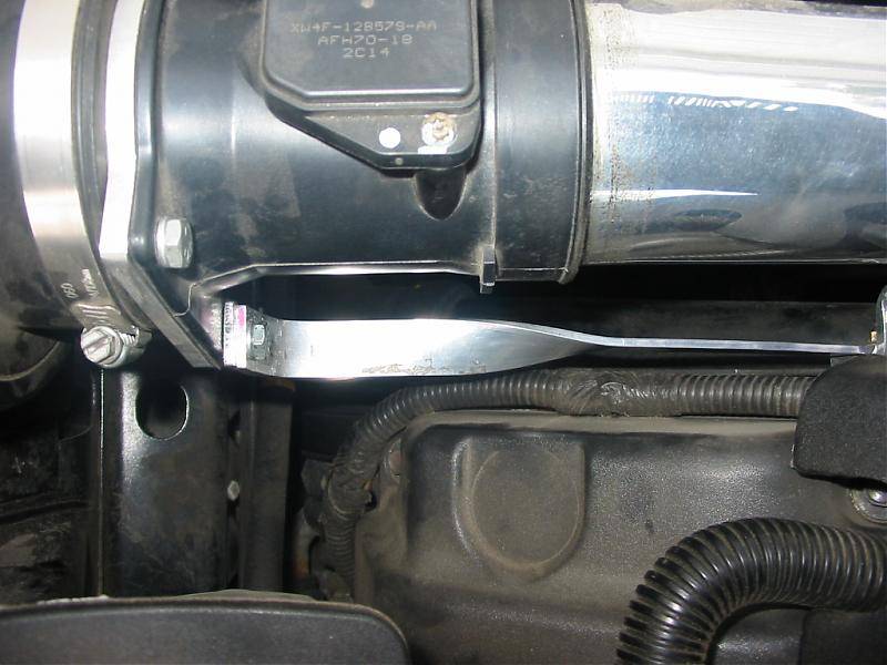

The major flaw is the KKM is designed to be attached to the STOCK intake tube. The KKM mounts to the chassis as the stock air box does. That works as the STOCK intake tube has a flex pc in it. When using the Aluminum or S.S. intake tube with the KKM unit you loose the flex part therefore everytime you touch the throttle you are pulling the KKM right off the intake. I don't care if you use masking tape, friction tape (I originally found that to work better) or even clamps.
The proper fix is to...
A. Solid mount the motor. This will keep the motor from pulling the KKM off but not the greatest option. (Yes I'm joking)
B. Loose the supplied KKM bracket and mount the KKM unit to the motor.
The products were designed obviously seperate from each other. The KKM was design to go on the STOCK tube with the flex built in. And while work great on the Aluminum or S.S. tube...its got that flaw.
I consider myself more capable than most "professionals"

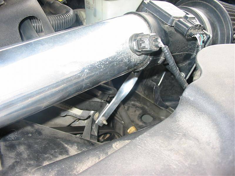

Make some brackets like these and be done for ever. I did and it works great and is what I would consider the right way.
The right way.
Also. A silicone connector would work well also but, without the bracket I believe it would bounce around alot will driving.
It won't. Mine is done that way and the connector holds it VERY tight and solid. There is zero bounce or movement happening with the MAFS & filter assembly with just a silicone or rubber connector and its accompanying hose clamps.
Cool. Either way the wrong way would be connecting it to the chassis without some means of flex.
Unless you never push your throttle down much....but even then its just a matter of time.
where the tube inserts into the MAF housing... looks like a perfect place for a clamp

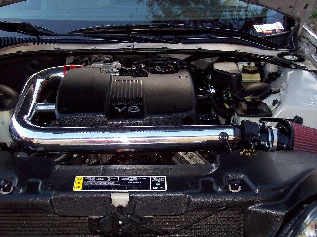

I see that the clamp goes around the part that you are saying does not compress. So If this does not work explain to me why ford put it there. Not saying it is right, but that is where it is even with the stock tube. actually I still have my stock tube and they are both rather hard abs plastic.intake pic.jpg
From looking at my closeups and my stock tube in my hand, only thing different mounting wise is my intake tube is now hard metal, not hard plastic.
