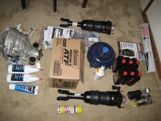

Thought you guys might like to see what I'm gonna be doing this weekend....
http://bp3.blogger.com/_ClJiOtKu3Z0/RcE8Dko-mmI/AAAAAAAAAA0/Dz3NlbHrUeQ/s320/IMG_0486.JPG
3.73's
Trac-Loc
3000 rpm stall torque converter
Baumann electronic controls shift kit
Mercon V w/ new filter
SCT Xcalibrator 2
Front air struts
New air compressor
rear shocks (not pictured)
new rear main seal w/ oil change
and umm... windshield wipers
I think I've got my work cut out for me this weekend.
well, I got the torque converter and the gears in. took me about 22 hours total. It would have been a lot less, but I ended up having to take the tranny out a second time cuz my friend didn't install the TC correctly. I wasn't very happy.
On sunday, i only had my wife helping me. Surprisingly, she was a very big help.
