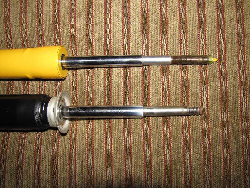

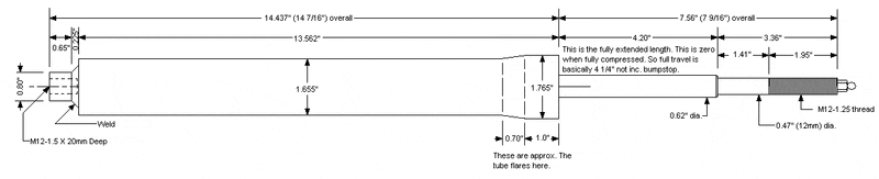

I broke out MS paint and took a "few" measurements. :D
Length measurements are accurate to about 0.050"
WOW! Very well done. :eek:
So now, what are the measurements of the stock shock tube? ID, length, etc.?

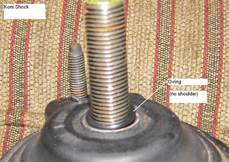

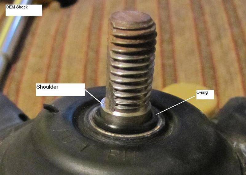

Unfortunately, the 14mm wouldn't work. There's a metal sleeve in the top of the air bag surrounded by rubber that's made for a 12mm rod and it's chamfered on both ends in order to fit O-rings. Drilling it to 14mm leaves no material to add a new chamfer, and without chamfer, you have no O-rings, and that means no seal.
There's also a major problem with the threaded part of the shaft not being correct for our needs. The portion of the rod above the "step" is critical, because you need a length of it to be unthreaded in order for the O-rings to seal. In fact, even the T-bird insert, as it is, has the thread going down too far, which causes the top O-ring to be up against the thread. My plan was to fill in the threads with metal-reinforced epoxy putty up past the O-ring, and then sand or file it smooth. Jeremi says it can be installed without the top O-ring, but I'd feel better if it was there.

What goes on top of the o-ring in this picture?
What about using an 12mm aluminum or copper sealing washer instead of the top o-ring, and some sealant on the threads and nut?
yeah, the top of that doesn't look like it would present that much of a problem to get sealed up.

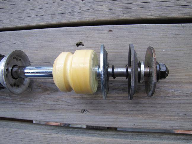

Three big-ass washers. Here's how it's all laid out...
The O-rings, when installed, are pressed into the chamfer in both ends of the metal sleeve, which as best as I can measure, is about 1.6" long. So you need at least that much length, in addition to the thickness of all the washers and the nut, so add another inch just to be safe. That makes a little over 2 1/2". If I'm reading the PDF right, the threaded portion of the rod above the shoulder is 50mm long, which is a little less than 2". Even if you could figure out an alternate way to seal it, I think it would still be too short. I guess you could eliminate all those washers on top, but that's way out of my limited expertise.

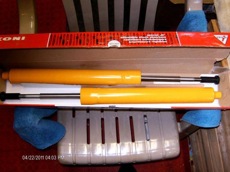

Look what showed up today! :D:):cool::p
Now all I need is a real good set of Gen 2 front air shocks. ;)
I took a look at a dead Arnott that I have, and these won't fit in them in any way that I could figure out. :(
