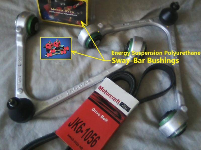

I have the parts already, but it's still on my :p "TO DO LIST". :p
:confused: Check & Verify the Diameter Size for your year/model LINCOLN LS Before Ordering...:confused:
