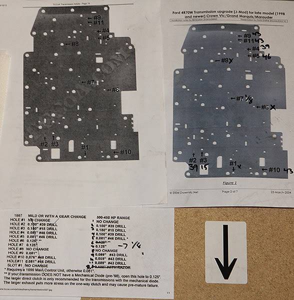

here are the specs I used and where I drilled, the crossed out lines are the ones I skipped, I used the image on the right, I guess I must have printed out that pdf a long while ago

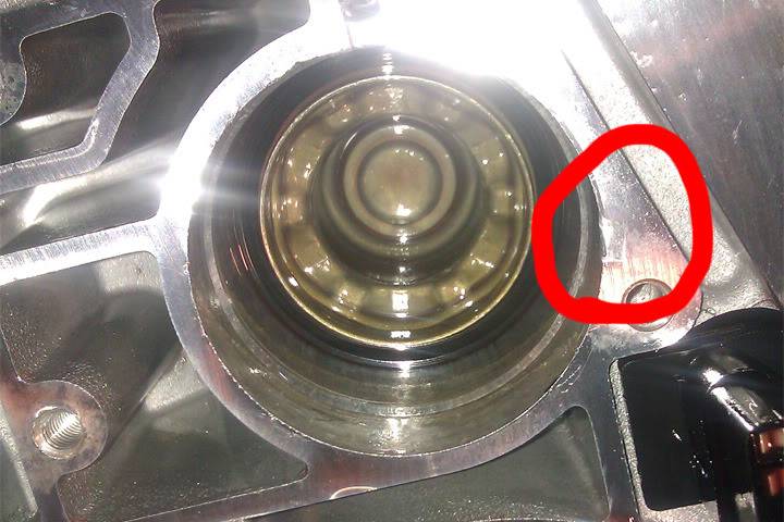

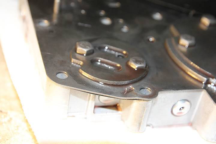

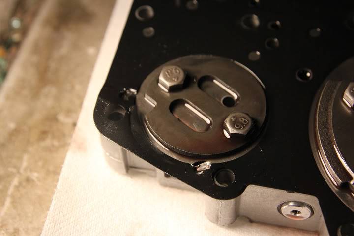

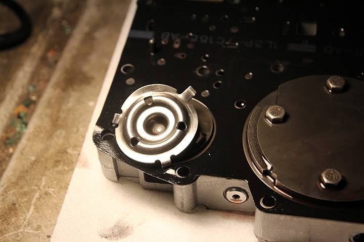

the pictures tell the story, I put the :q:q:q:qing cap on backwards and ruined everything
how I put it on backwards is beyond me, such a simple and obvious thing
