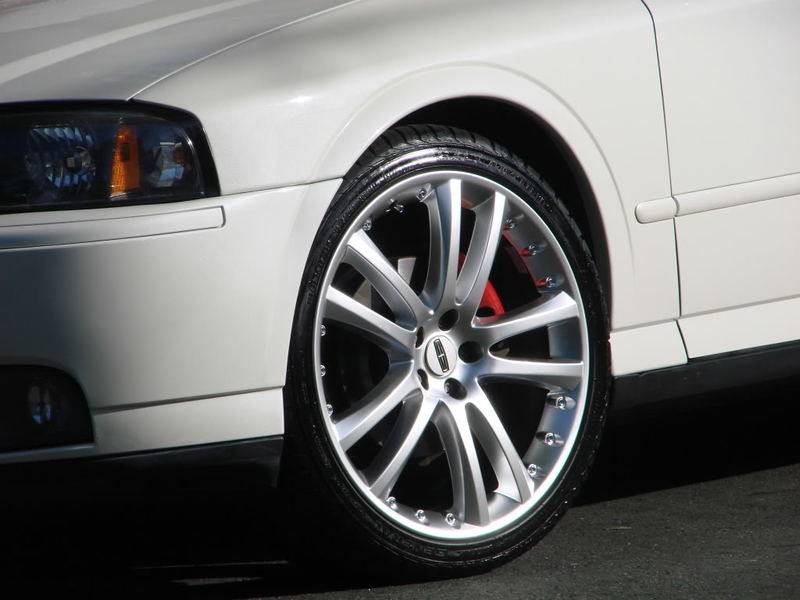

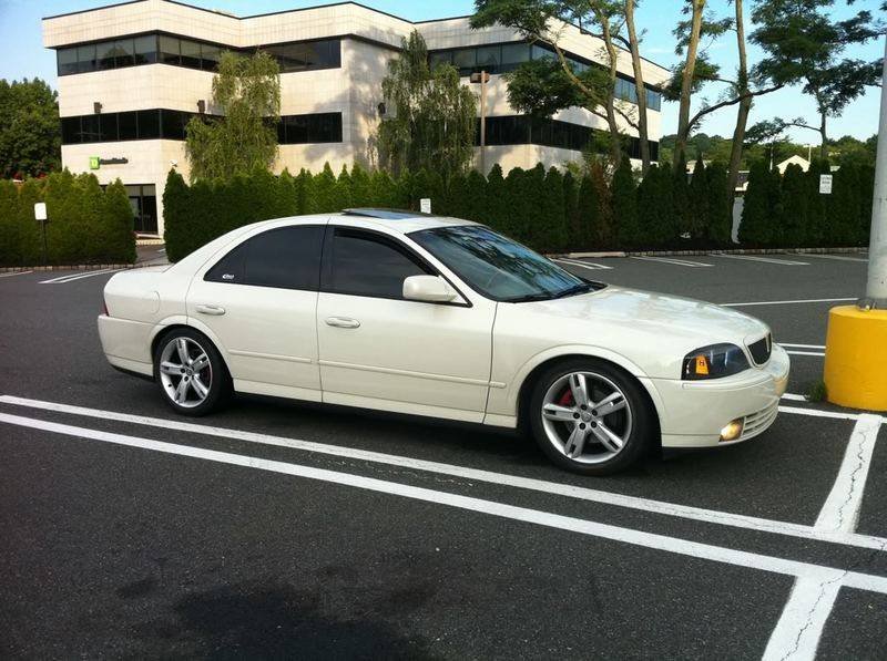

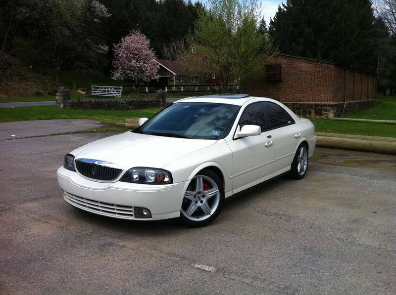

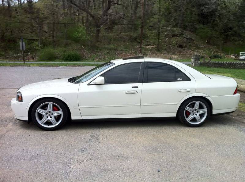

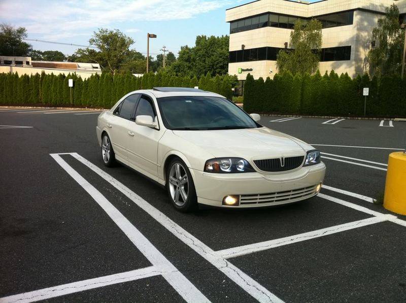

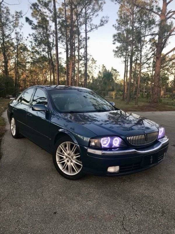

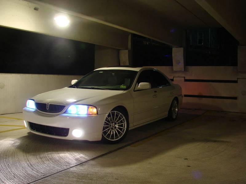

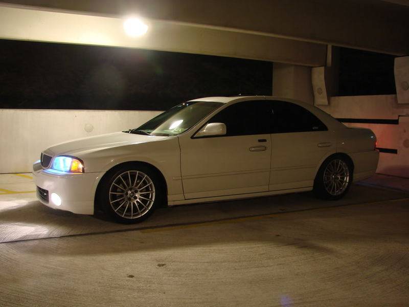

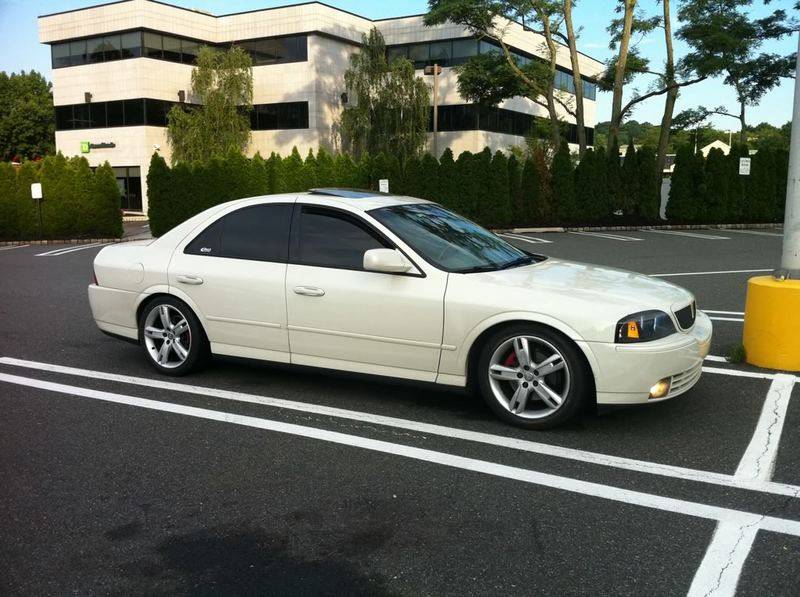

I ended up going with 245/45-18 and I'm please with the results.
Jaguar Dynamic 18x8 49mm offset
Continental Extreme Contact DW tires
edit...They look bigger and better in person than they do in these pics.
Those sure look good, especially with the Vivid Red.

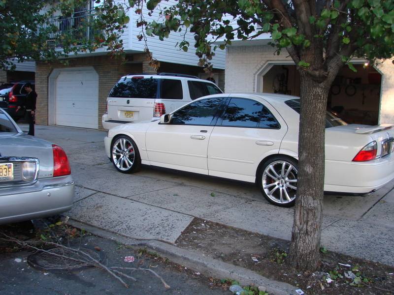

Thanks. I really wanted 18" Vulcan's from an S-Type R, but I came across these Dynamics locally for only $85 a piece so I couldn't pass them up.

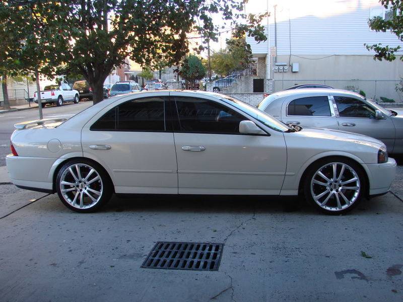

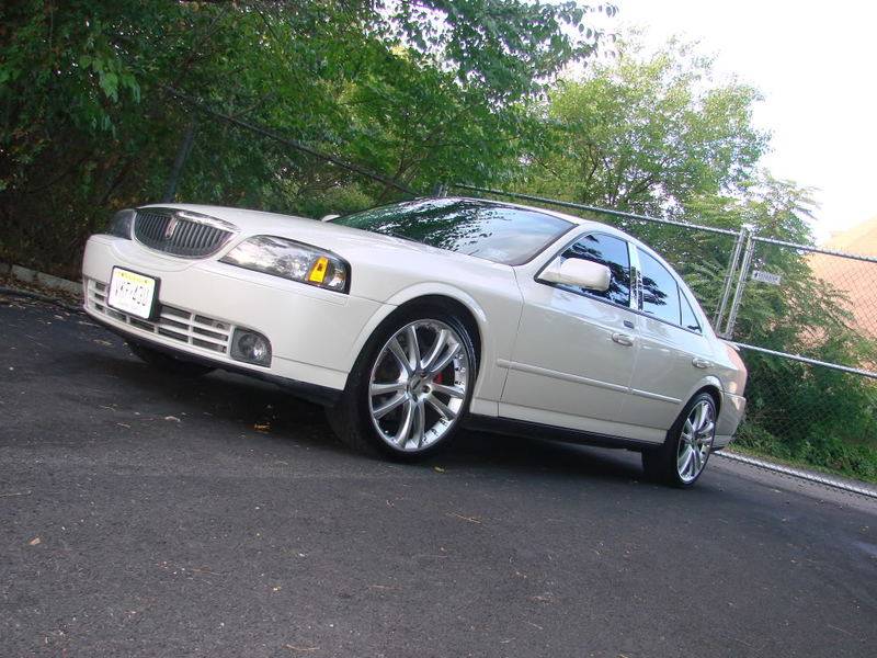

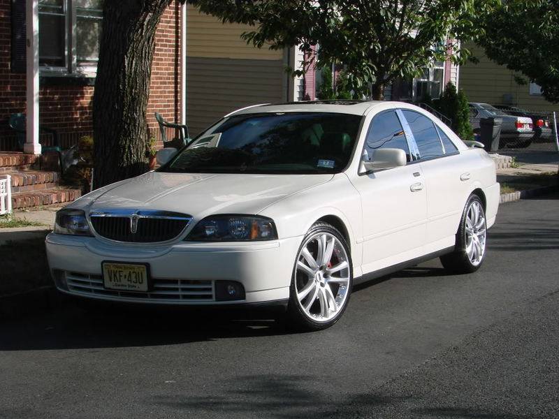

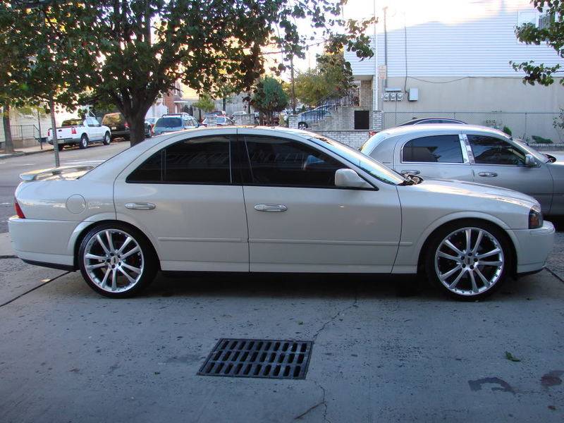

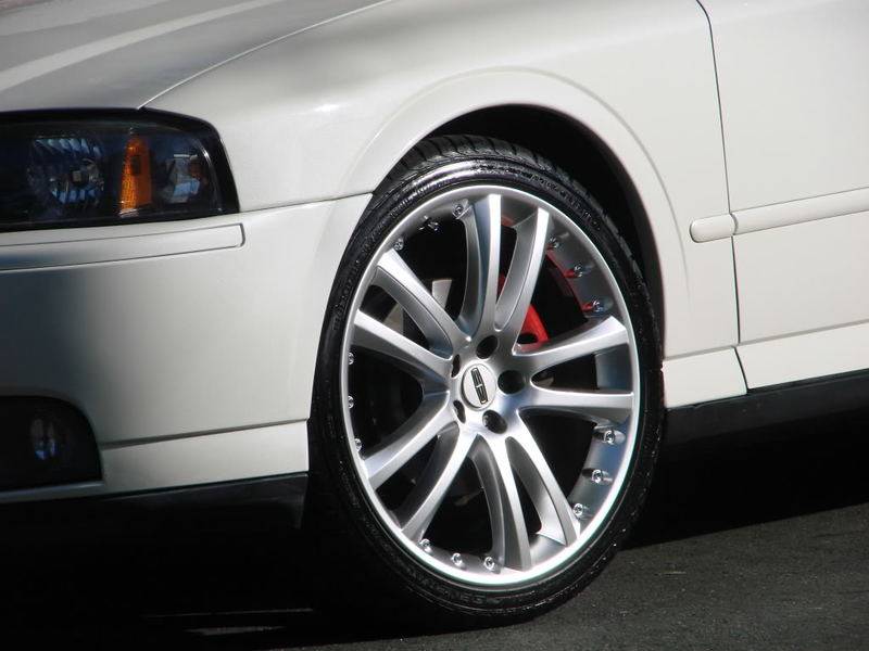

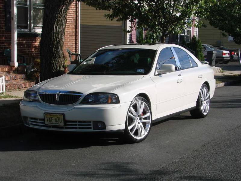

Has anyone ever tried to fit the 20 inch Callisto on their ls??
Can't say, as long as you don't go wider then 9.5 in the rear any 20" fits. Apparently only rubs slightly on bounce with people in the rear seats.

A 2004 XJ8 has the same 5x108 bolt pattern as the LS. It's the 2003 and older XJ's that had the larger 5x120 bolt pattern so your 18x8 Dynamics from the '04 XJ8 will fit without any issues. This is exactly what I am running on my car with 245/45-18 tires (see post #275 of this thread).

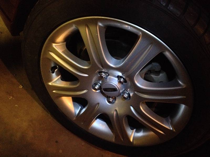

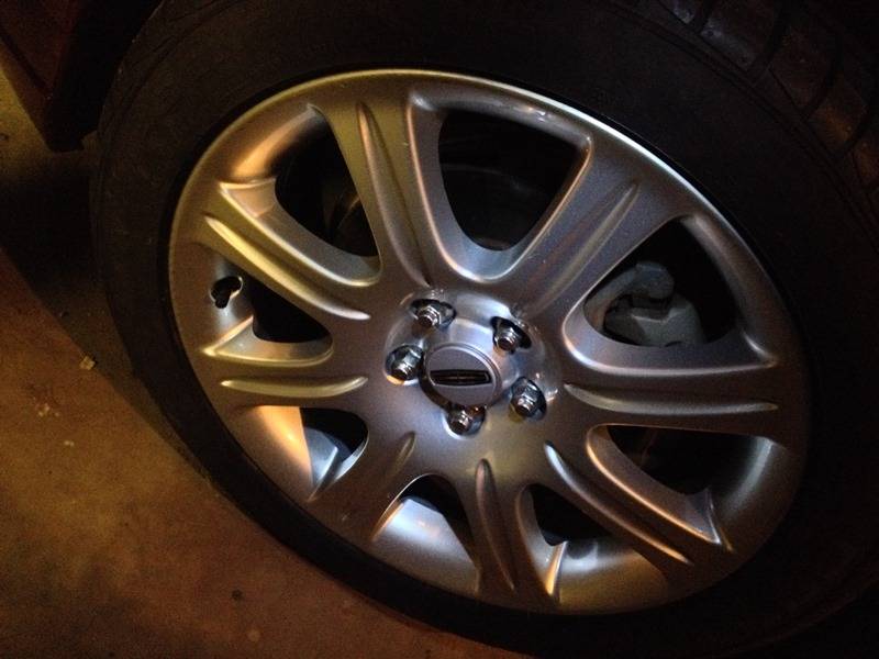

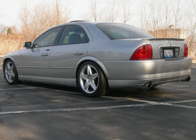

I'm currently running center caps from the factory LS 17" 5-spoke wheels. They are a bit larger and don't fit perfectly flush, but they do work and I doubt that most people would even notice that they weren't correct.

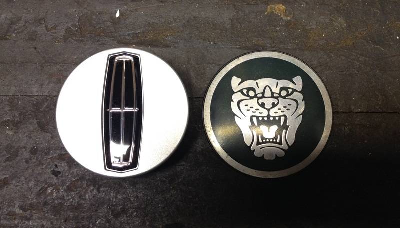

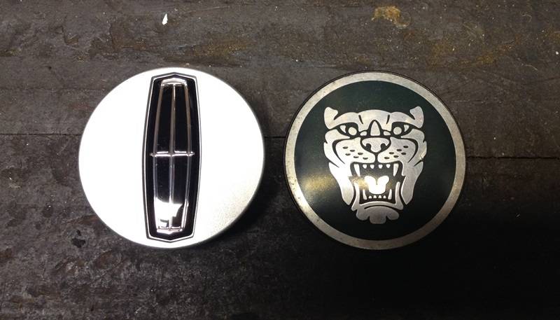

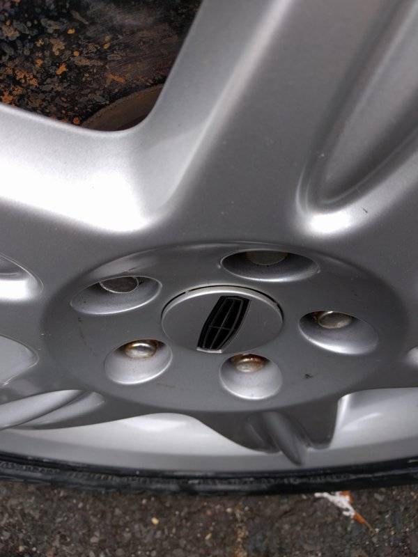

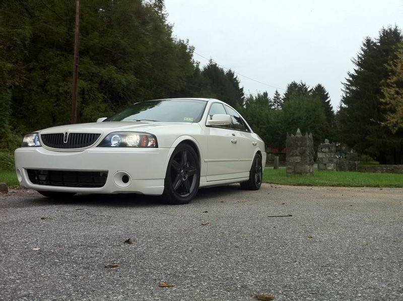

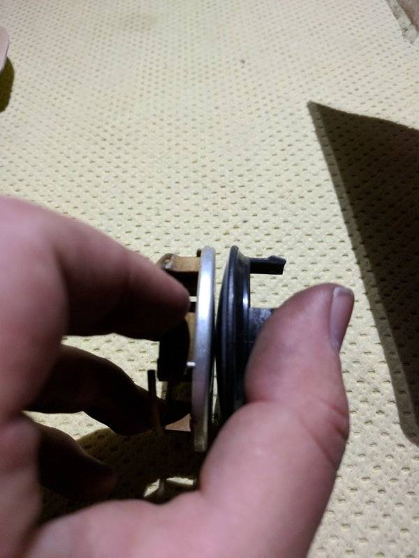

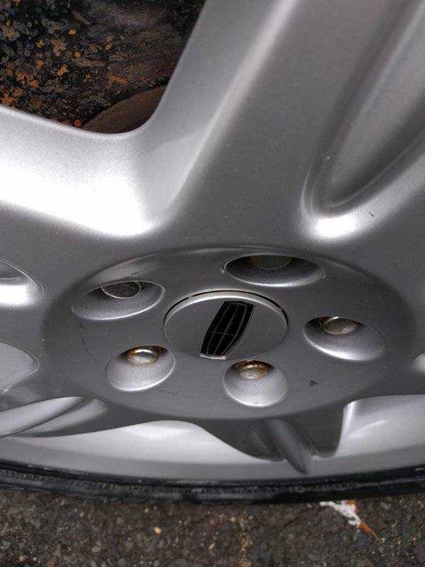

They're similar to the factory style on that wheel, but they really don't look right on the StR Zeus unfortunately. The side profile shows the LS cap has a square inner shoulder while the Jag cap has a curved shoulder. I switched to the Jag caps for now while I look around for ideas

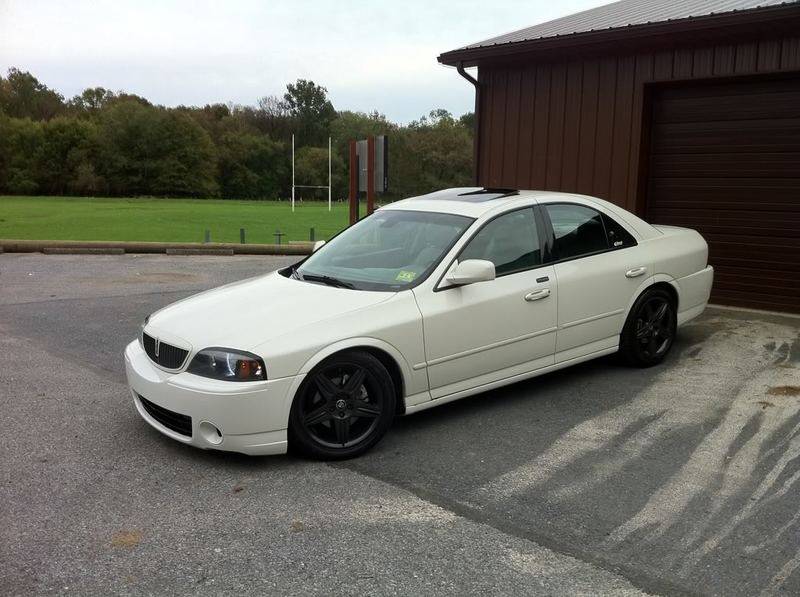

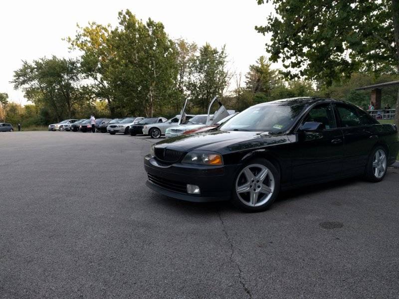

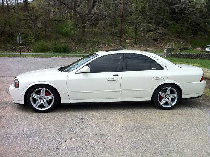

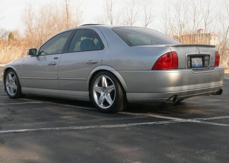

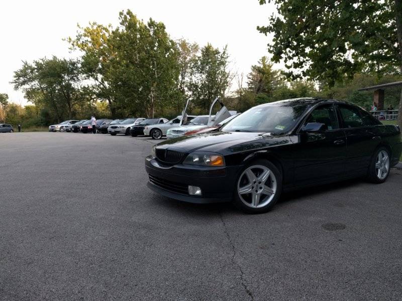

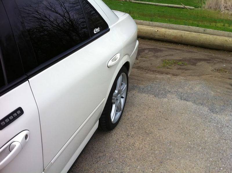

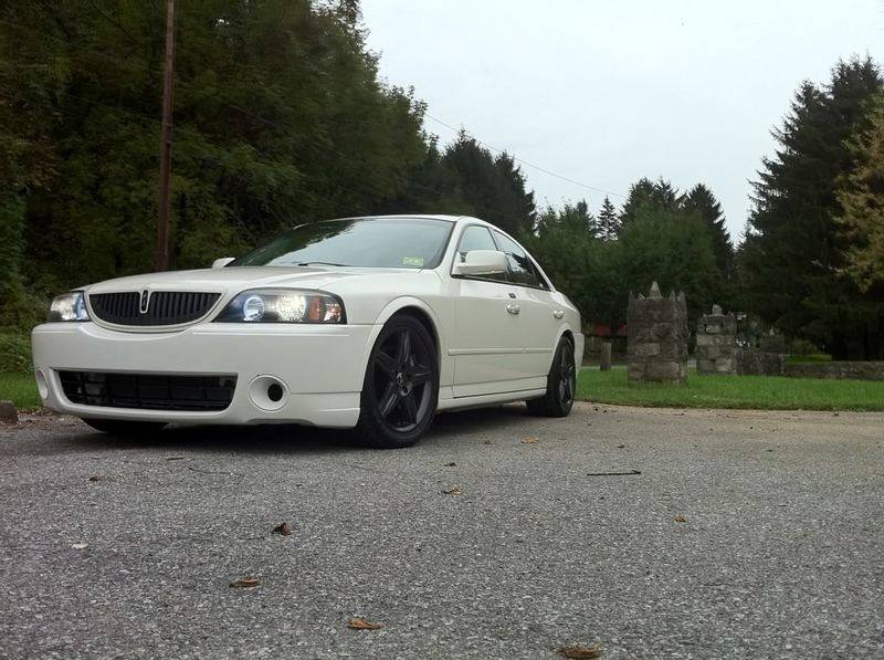

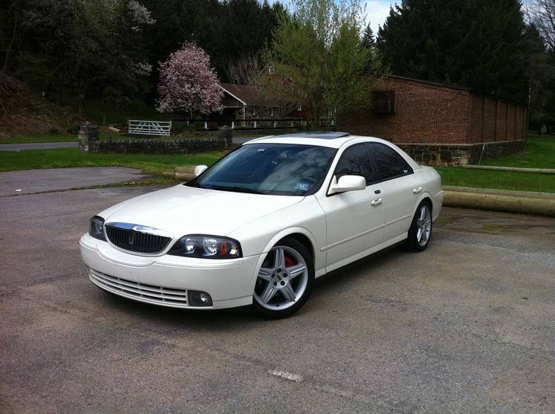

I'm in love with the fitment on the rear though. 18x9.5 +60mm with a 285/35/r18 tire. Now I just need a drop
(Edit: full wheel details: Front is 18x8+60 w/ 255/40/r18 and rear is 18x9.5+60 w/ 285/35/r18)

They're similar to the factory style on that wheel, but they really don't look right on the StR Zeus unfortunately. The side profile shows the LS cap has a square inner shoulder while the Jag cap has a curved shoulder. I switched to the Jag caps for now while I look around for ideas.
Do you think that if you were to grind/sand the inside of the square edge so to make it more tapered that it would allow it to fit more flush?
I'm in love with the fitment on the rear though. 18x9.5 +60mm with a 285/35/r18 tire. Now I just need a drop.
Agreed. They look very nice on there. :cool:

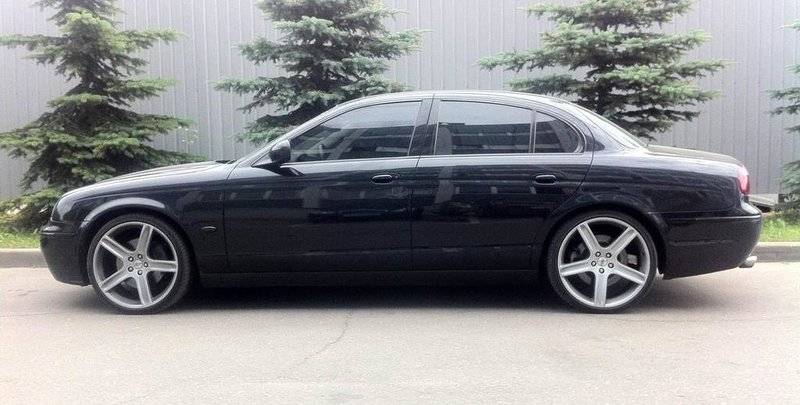

Anyone have any experience with XFR-s wheels? They are twenties. 305 on the rear and 275 on the front. It is a set staggered but the seller doesn't know the specs.
Bolt pattern is same, but being 20's it will be hard to find tires that wont scrub. If you havn't rebuilt the suspension (back to stock height with age sag) or lowered it then doubt they would work at all.

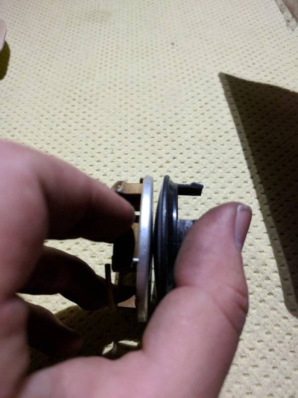

if you shave off those little plastic parts that stick out from the back of the Lincoln's center cap then they fit really well on the Jaguar wheels. Also I would highly recommend 20mm hub centric spacers for the front wheels, looks way better with em, they are about $100-120 on ebay new.

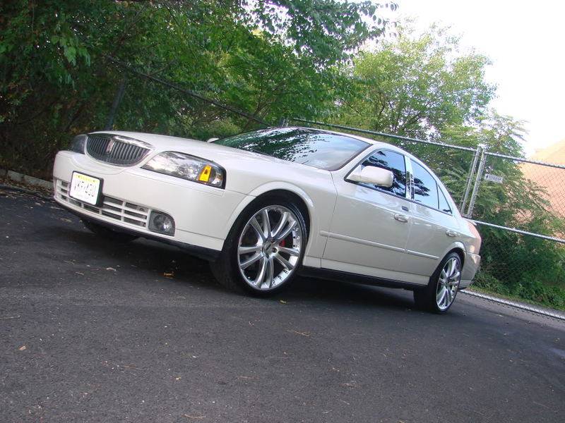

I feel I’ve owned enough of these, and there is enough interest among the community that I wanted to get this “database” sort of speak, going that explains which wheels fit, with what equipment, and of course their specs. Rolling has a similar thread going but I wanted this one to be specific to OEM/OEM style Jag wheels because…well… I’m biased LOL. I love Jag wheels because they allow us to upgrade the looks of our cars without taking away from the classy/luxurious/ stock look of the LS. Hope this can help someone and eliminate the need for any new “will these jag wheels fit?” threads.
Please add your Jag wheels, and correct me if any of my info is wrong. Thanks. Enjoy!

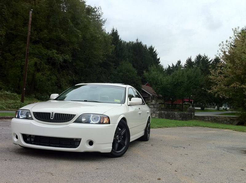

Zeus Wheels (From 03-04 STR)
Front:
Size—18x8
Offset—60
Tire—245/40
Rear:
Size—18x9.5
Offset—60
Tire—275/35 (Some have made 285’s work)
Equipment:
OEM Sport Struts
Eibach Pro kit Lowering Springs
Dark Charcoal:
Silver:
02V8Sport’s LS with 285’s in the rear:

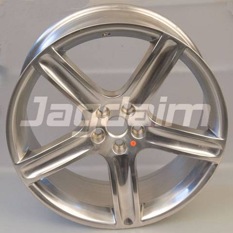

Vulcan Wheels (From 05-07? STR)
Front:
Size—18x8
Offset—60
Tire—245/40
Rear:
Size—18x9.5
Offset—60

Senta Wheels (From 09 XF)
***Originally came equipped on Jag vehicles with 8.5” fronts and 9.5” rears. THE REARS WILL NOT FIT. You need 4 Fronts, 8.5”s all around. Replicas were also available from usarim.com, 8.5”s all around, but currently out of stock. ***
Offset: 49
Tire: 245/35
Equipment:
OEM Sport Struts
Eibach Pro Kit Lowering Springs
* Minor rubbing at full lock and major dips.
*Others have used 245/30’s and 255’s. Maybe they will Chime in with their experiences.
Stock Height:
Lowered:

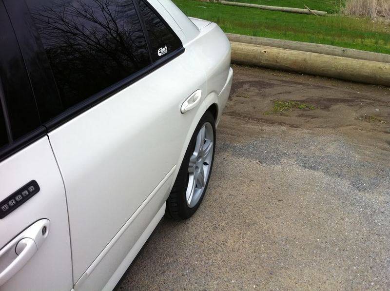

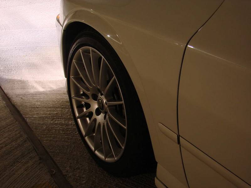

Tucana Wheels ( From XJ8)
Specs:
Size—18x8
Offset—49
Tire—Currently using 225/45 front and 245/45 rear.
*Love the look in the front, not so much the rear. Too much sidewall, will be likely going with 255/40’s in the summer time.
