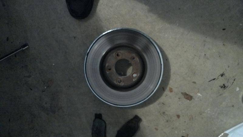

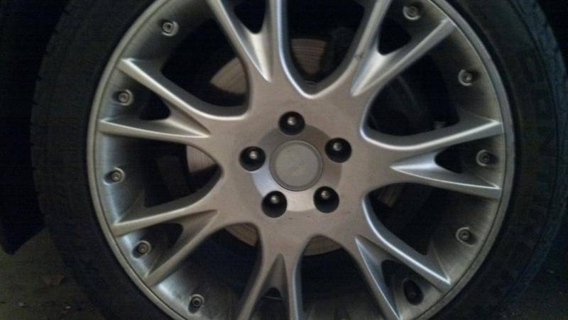

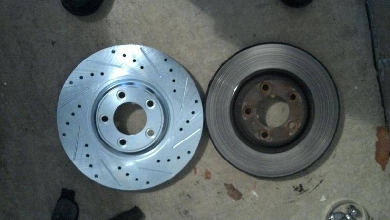

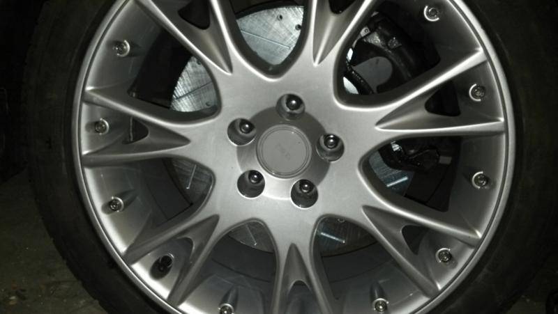

I combined Kumba's Jaguar S-type Sport larger rotors with the RotorPros slotted and cross drilled group buy. I got the fronts mounted tonight, but its been storming so these pics aren't great. They look awesome in person, very nice quality. I have the rears the mount yet before i take it for a test drive, that will be in the morning.
For the record the deal was $280 shipped for the larger upgrade and ceramic pads. I passed on the SS brake lines, although i may regret that soon haha.
Hopefully these pics load and i'll take better ones tomorrow! First pic is the old rotor, second is a side by side of the old and new rotor, third pic is the old rotor on top of the new one, and final is a shot of them mounted. Tomorrow i'll get some distance shots.

ok, I give - that rotor does look damn sexy!

Has anyone been able to verify if the factory 17" wheels will still clear the caliper with this upgrade?
