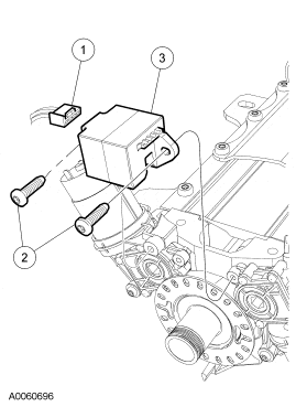

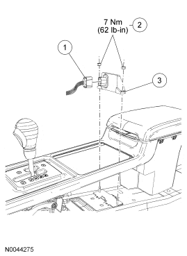

            Do you have any idea where the steering angle sensor is and the YAW sensor is located ?
          • joegr
            joegr Dedicated LVC Member
            Messages:
            18,393
            Likes Received:
            2743
            Joined:
            Dec 10, 2005
            Location:
            Gulfport
            Sure.
            The steering angle sensor is at the bottom of the steering column under the dash. It's an optical sensor.
            The yaw sensor is under the cup holders.
            I've seen particular error codes from these when they are a problem, not calibration codes.
            • Like Like x 1

              • joegr
                Messages:
                18,393
                Likes Received:
                2743
                Joined:
                Dec 10, 2005
                Location:
                Gulfport
                Looks right.

                    I ordered the Yaw sensor because the previous owner of this car did not take care of it. There was a lot of sticky stuff under the center console so it seemed like someone spilled a soda I figured it was not a bad idea to replace it because of that. As far as me replacing the Steering angle sensor I did a carfax and see that the car had been in a wreck with front end damage so I figured it would not be bad to replace in that case. I know that I could be wrong but I figured since all of that it might be a good place to start.
