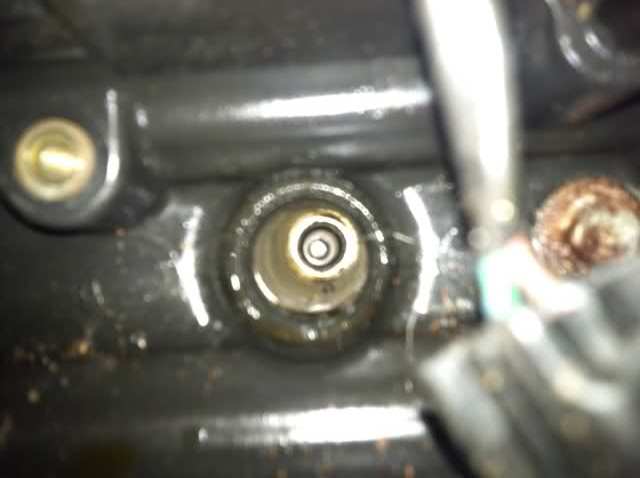

I think water got in there and you started to develop aluminum oxide, then oil also started to go in as well, mixing up the color.
Unfortunately you don't have a picture of it before it got sprayed with PB. But if you look at your picture at message 22 the valve cover bolt is rusted. That usually never happens under the coil cover unless water has seeped in. #8 being at the back and lowest point on the engine valve cover would be where water would pool.
I would take some straight sections of clothes hanger wire and run it around the plug trying to break it up, then use a vac to suck out the debris as you go along.
I'm fairly certain the first pic in the thread is before PB
Oil is known to develop a "creamy coffee" color when water seeps in from a cooling system leak though.
Yeah first picture in the thread is before putting anything in the well. It comes out in a muddy sandy texture crap so I don't understand how it could be an epoxy. I am just hesitant to take it out and have the possibility of stripped plug threads not being able to fix that right now. I was wondering why that bolt was so corroded. Also one of the bolts for that little cover over the coils was missing maybe water was getting in over there...it coincidentally was the bolt right above that coil as well.
Does (or did) that COP sit down all the way over the plug? Maybe they left that bolt off because they couldn't get the coil fully seated after they put whatever they put in there?
It may not be epoxy, but the clues point to it being something someone put in there on purpose. If you are lucky, it was just a crazy attempt to stop the oil leak. If you are not lucky, it was a crazy attempt to deal with a stripped out spark plug hole.
I still ask the same question. Do the other wells look the same or just this one?
The bolt I speak of us for the plate that goes over all the coils. Not the one for the actual coil itself.

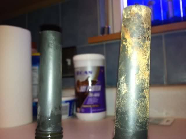

Okay I decided to take some pictures of the coil and well to the left of cylinder 8 to show you guys the difference. There was the same amount of oil in each one, very little. None pooled at the bottom in either one just a little up towards the o-rings. Look how discolored cylinder 8 is compared to the other one. The other well does NOT have that stuff at the bottom.

It might have been left off just because it was a pain to get to. This may also be why water made it into that side.
well i say keep trying to dig it out... and see if the plug unscrews or not... although this might leave you without a car for a couple days
That is clearly a rusty color I mean each boot had the same amount of oil on them and one looks fine and one looks rusted. The missing element has to be water yeah? Which if water gets into the well it would cause corrosion especially when theres a charge involved. I'm feeling like I have a leak in that cover instead of a plug that is stripped.

GOOD NEWS. Socket is gripping the plug now. It's almost degunked. Im soaking it one more time in PB to try and get some of those particles floating in it. And to see whats going on a little better.
