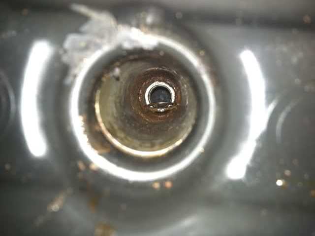

Okay....I cleaned it up as much as I could with my can of air and at least 75 Q-tips and one iron maiden shirt. Nothing seemed to fall into the cylinder...i hope.

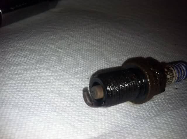

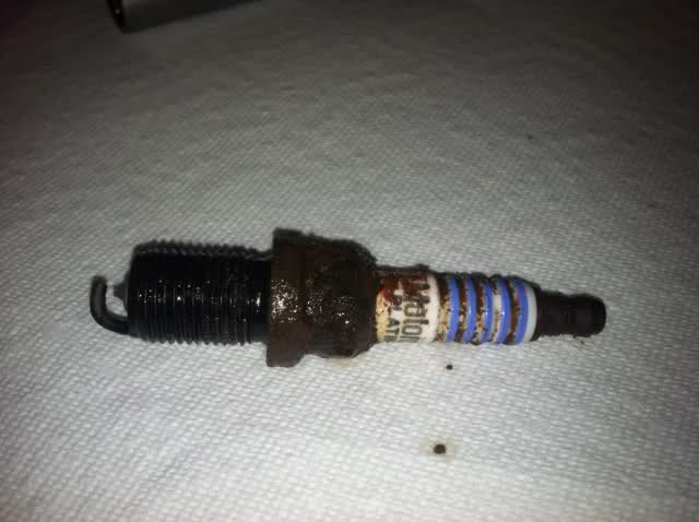

I got the plug out... it threaded out HOWEVER there was a ring that was leftover at the bottom. I took a crafty iphone picture for you guys. Is this just a ring that goes on the plug? How should I get it out as well without losing it in the hole or something.
So after I get a new plug and if it threads in nicely and such... what do we think is the reasoning for the weirdness? It DID threat out normally. Some PB blaster penetrated behind the spark plug as well...hopefully that just burns out of the cylinder or something -____- might as well just change all my plugs while im in here. the VCG will have to wait a couple weeks. but my new coil is warrantied so if it poops out in that timeframe ill just clean it real good and get a new one.
That's the plug gasket. Just bend a small hook in the end of your coat hangar and fish it out. The new ones will have a new gasket.

Thanks, I bought one of those extender magnet things. Best $3 ever haha.
New plug (threaded in perfectly) and coil is in, no more misfires....for now. VCG's are on my to do list. Thanks for all the help and opinions everyone. Glad to see my first thread on this site got so much attention!

Still, that first pic is completely a mystery. What the frack was that stuff?
After it was saturated in PB Blaster it turned into a gritty oil looking substance. The plugs in the motor are the factory plugs if I had to guess. So perhaps this coil has been toast for 50k miles or something and nobody bothered to deal with it. It could be thousands of miles of gunk that just super heated and formed a soot.

Did you get that ring out? i also used an antenna magnet down there to pick up any debris
I think that ring is too big to fit through the hole. I would go after it with a pair of needle nose pliers. That's what I use to get my plugs out. Glad to see that it wasn't a bigger problem.
Message 81 stated he got the new plug in and it's running, so he got the gasket out.
