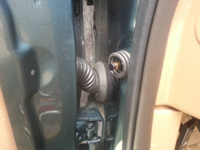

Yours looked pretty worn out but either way, now you know you have new and the other issue was resolved. They're an easy swap aren't they? Get those rubber boots in there ASAP to help protect that new $15 investment. :)

Yours looked pretty warn out but either way, now you know you have new and the other issue was resolved. They're an easy swap aren't they? Get those rubber boots in there ASAP to help protect that new $15 investment. :)

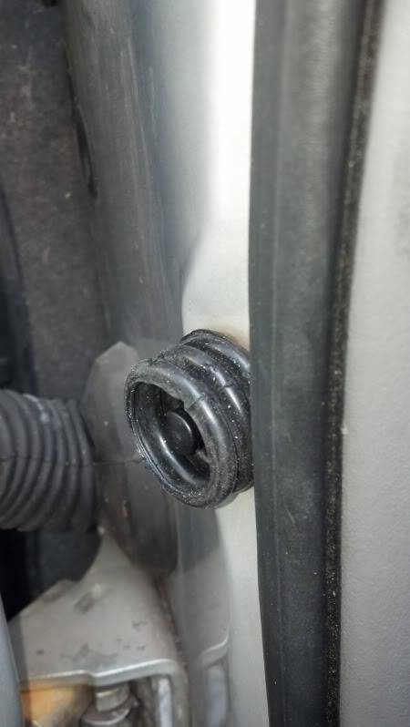

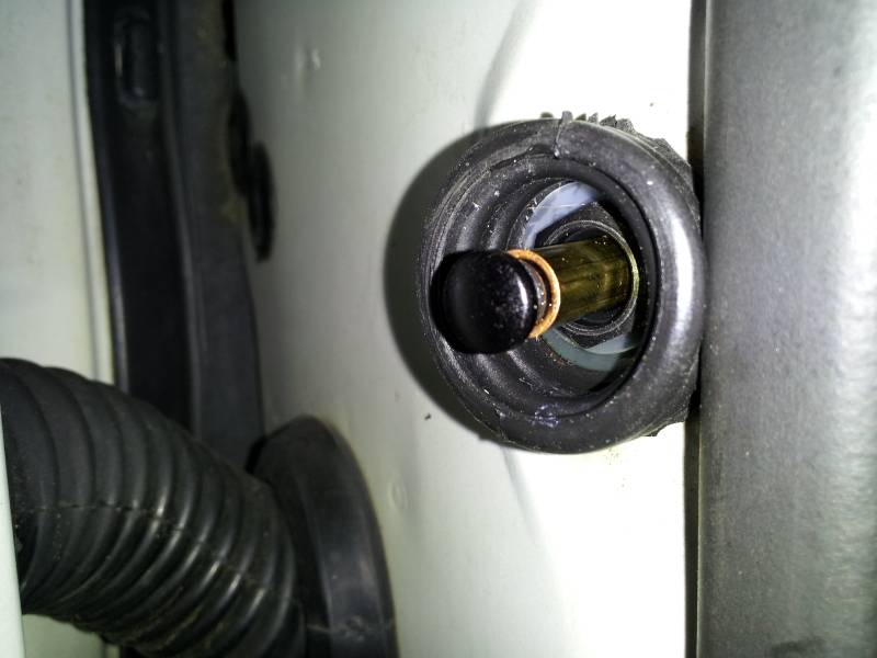

Put the boots on with the switches:D
Good deal. :)
Looks good Willis lol but the main thing is that you found the problem and got it fixed and ended up with new rubber surrounds and switches. I'm sure they were on their way to failure soon, if they weren't already acting up before the swap.

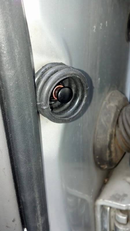

Reminds me of mine...

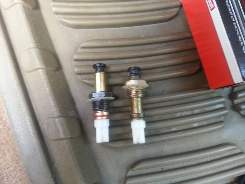

Well I got my door switches in the mail today and tossed them in..had a little hiccup when I noticed how much farther the new ones stuck out, looked at the old one that came out and compared them..at first I thought they were the wrong switches. I tried slowly closing my door with the switch in and the door would not shut all the way because of how far they protruded. I ended up taking it back out, putting it in the vise and lightly tapping it with a hammer to slide the nut farther down to where the original one was.
unfortunately this did not cure my problem, I still have the intermittent non working key pad with interior lights that occationally stay on after locking and shutting the door, however mine do not stay on for the 45 second time out period like some have mentioned. I sat there and counted it out after closing my door and the first time it acted up the lights stayed on for 20 seconds and after I repeated the process to see if the same thing would occur, the lights stayed on for like 10 seconds..so there's no real pattern here..I don't get it. Oh well, at least I have some fresh motorcraft switches in there for the future. I'll have to find the thread on the other switches inside the latch that some other people have talked about before. Once I find it ill post the thread link on here.
