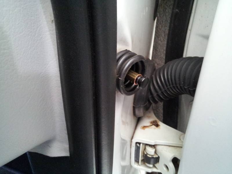

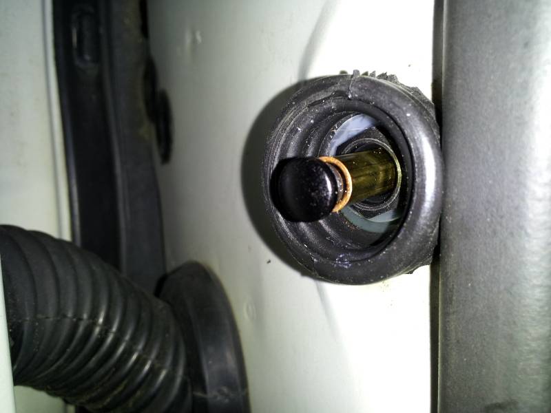

My keypad didn't work half the time either until I swapped out switches for new ones. Since the swap, works every time now. I think two Motorcraft switches can be had off rockauto for under $10.00 with shipping. Not like it would be a major loss or really considered "throwing parts at it". Now when you spend $40 or more for something that you don't know if it's going to fix the problem and not be any better, then I consider that "throwing parts at it". Kinda hard to go wrong with new door jamb switches. Just imagine since 1995, how many times they have been in and out, in and out and been sprayed with WD-40 which washes away the important (lithium) grease. All I can say is that they worked for me. I done both sides for peace of mind and because they were too cheap not to.
Old switch, new box.
New switch installed.
One more thing I need to add is that when my drivers side switch tip fell out, I tried putting it back in and this is where it got confusing. When I pushed it in, the interior lights came on. When I let it fall out, they went back off. I never held it in long enough for a 45 second time out. Maybe that's what confused me. I applied power to activate interior lights but didn't hold it in for the full 45 seconds. Since the swap, it vents right then, the lights don't just come one for no reason and the car can set for days and the keypad still works on the first touch.

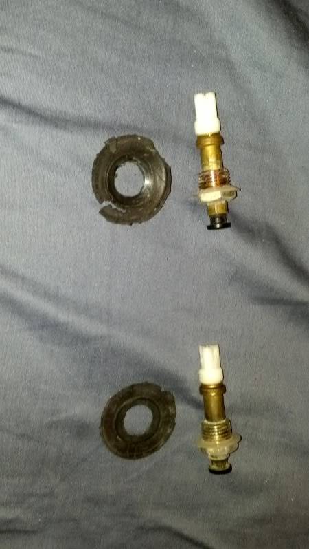

Well got my switches today:D, but they didnt fix it:(, but then i fixed it:D
My car has an after market remote start on it and there is what i believe to be a programming button on the drivers kick panel, i held the switch the horn chirped and the key fob did not work, held the button again while holding lock button on remote and the key fob worked and my lights shut off immediately, then i started the car and the lights again shut off immediately.:D:D
So in the long run I got some new door switches:D
and heres the old ones along with the old rubber seals that were almost completely gone:
