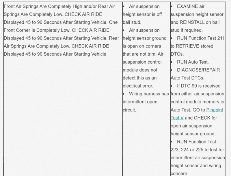

Maybe I'm not reading the above posting right but it seems there is a slight contradiction there.... When I bought my 97 I ran it for a couple months with the front deflating every time you shut the car off. I researched everything there is to know about the system and reviewed the shop manual on the trouble shooting of the system. Only after all that thoughtful effort, I decided I'm not getting any younger in my wrenching abilities so it boiled down to springs with air shocks on the rear. In comparing the ride before and after, I think I made a good decision. I don't knock any one for wanting it factory. Iv been wrenching since 1976 at a Chevy Olds dealership and have a little knowledge about electronic systems as they continue to get old..... like me, they tend to not work so well with failures when you least expect it. Good luck finding your above issues ;)
Thanks no contradiction, to clarify, it has been fine until just the this winter, when the front right has started to go down in extreme cold weather, over night. But the last week or two when the car started raising to the max height if i left the system on, it no longer lowered in the cold and yes I let the system rise until normal height, then i turned it off.
I thought it was the front right height sensor. i have done some more searching and found it could be a wiring ground fault.
if you look at the chart above, (this is straight from the ford manual) according to the symptoms given, if the sensors are correctly installed, then the problem is electrical
double check fuses 28, in the instrument panel fuse panel and fuse 4 and 13 in the engine compartment fuse panel
at the air suspension/steering module, pin 10 (bk/pk) wire is common to all 3 height sensors
pin 28 (pk/w)wire is common to all 3 sensors
pin 7(pk/bk) is for l/f sensor
pin 8 (t) is for the r/f sensor
pin 9 is for the rear sensor
unplug the suspension module and all sensors check each circuit for opens, grounds and shorts
if the circuits are good and the sensors are installed properly then all that is left is the module
