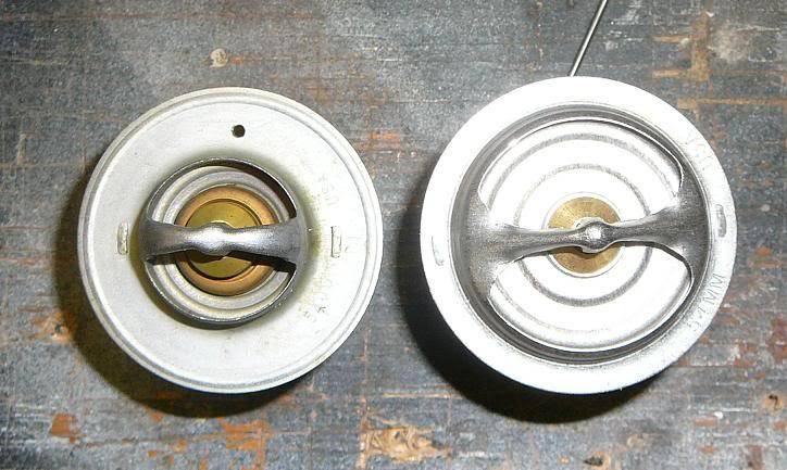

Had the same problem on my truck. Make sure to change the t-stat with an OEM one because the aftermarket one restricts the flow of coolant from the radiator and also allows hot coolant to recirculate through the engine.
The one on the right is the stock one and the one on the left is aftermarket. It will cause additional problems if you don’t go Motorcraft.
Credit: racecougar

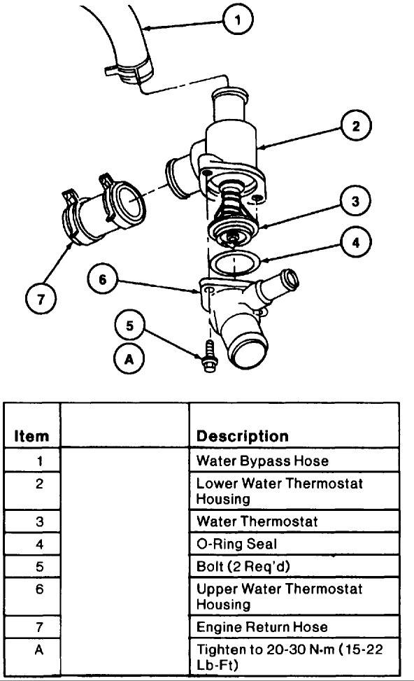

Remove the battery and tray, which will give you room to work on the t-stat. It should take about 1-2 hours and have a good set of channel locks or one of THESE
Here is the exploded view, bolts are accessed through the bottom.
1-2 hours? Remove battery ??
Do it from the bottom, 10 minutes
10mm?, 1' long 3/8 extension, ratchet
The one on the right is from Motorcraft, but it isn't the stock tstat. It's a 180 degree unit.
I also do it from the top because then I don't have to get under the car and get dripped on, except maybe to tighten the lower radiator hose clamp on the radiator end. I prefer to remove the entire thermostat housing and install the thermostat off the car. I can then be sure the o-ring is seated right and alternatively tighten the screws. I've got it down pretty good now and it takes me an hour tops and I make very little mess.
