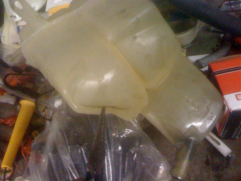

Just a quick and dirty how-to for those thinking about replacing the coolant degas tank. My tank was leaking and had numerous cracks throughout, and it had to be replaced.

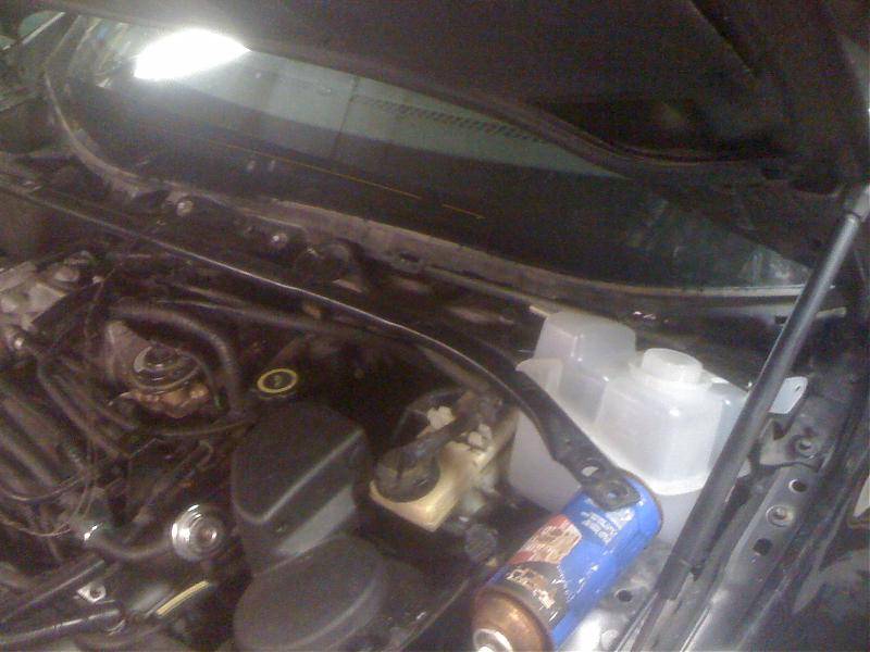

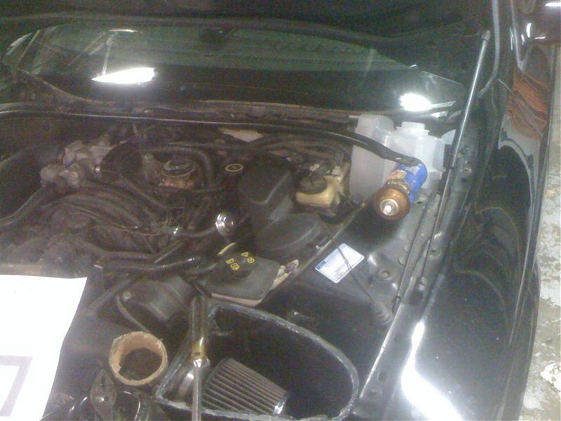

Steps:
1. Remove wipers
2. Remove plastic cowl under wipers
3. Remove the two bolts on the brace that connects to the shock towers. (You do NOT need to remove the entire brace...just the two bolts. I broke a bolt and had to replace it since they are rusted into place. I recommend getting a torch to heat the bolts from underneath the wheel well. Once heated, they are easy to remove)
4. Prop up the brace.
5. Disconnect tank and pull it out.
6. Reverse to reassemble.

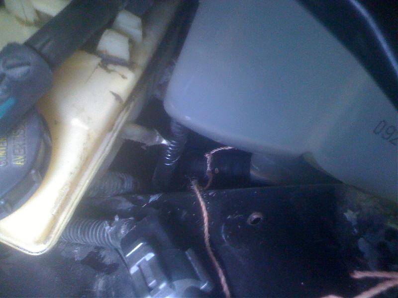

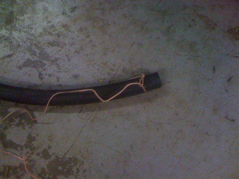

It can be very tricky to get the old hose off the tank and the new hose and hose clamp back on. I used a string and noose setup and it worked nicely.

there is a coupling about mid-point under the cowl that you can undo, pull out the tank with the 2' of hose attached to it. Move that hose over to the new tank and the feed it back and recouple.
It's a lot easier than trying to attach the hose to the bottom of the tank, that does not have enough slack to get your hand in.
Another approach is to leave the bottom hose connected to the tank and disconnect that hose where it attaches to a metal tube at the firewall by the brake booster. If you get the new tank from Ford, then it comes with the lower hose already attached anyway.
