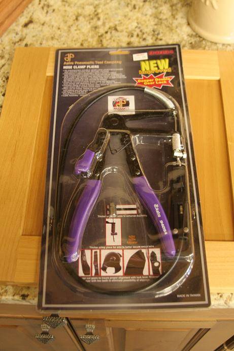

No hose pliers at Carquest. Did pick this up for 39.99 + tax:
Wondering why they would use PURPLE on a hose clamp pliers. When is a woman going to use these? (generally speaking, I know there are some female mechanics out there, but not enough to necessitate using feminine colors).
