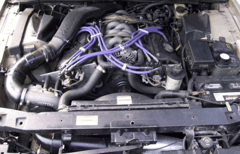

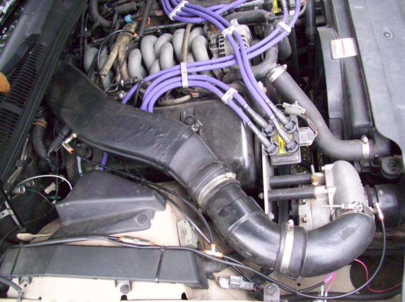

Hello bmergner. It is not a kit it is all custom with a Vortech S-3, a idler and a plate of aluminum. Also some custom spacers and household pluming supply's.
thanks for the update, it looked like you did a custom install. i have been thinking of doing something like u have and those pics REALLY helped.... lookd great..

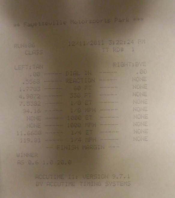

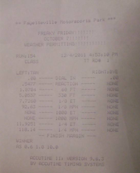

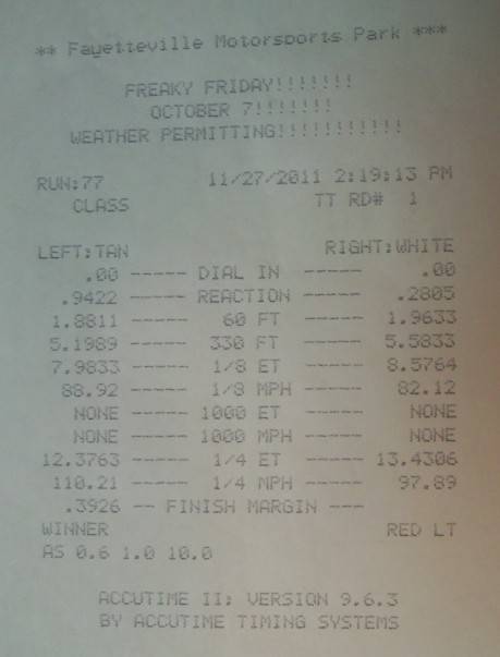

Ran a new personal best today 12.37@110.21
How did you pick up 10 mph from the 12.37@110.21 run to the
11.66@119.81mph run?
Thanks Kirk, I sure your going to run better also with a tune. On the power end there were three things that helped. Closing up the spark plug gap to .038 . Switched to running a 50/50 mixture of alcohol and water instead of washer fluid in the meth injection and it being colder. To help make it faster we also did some things to lighten it. On the front we mounted a set of Aluminum spare tire wheels with a set of the lightest used tires I could find. Also we removed the passenger and back seats. Also the battery was moved to the trunk to help launch it. That video of running RobertP was deleted because I have a better one Supercharged Mark VIII Vs Supercharged Thunderbird - YouTube
