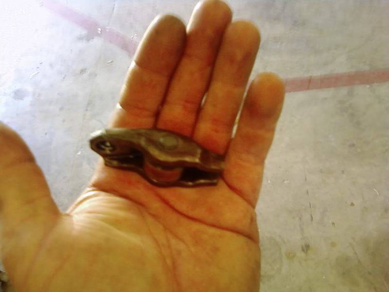

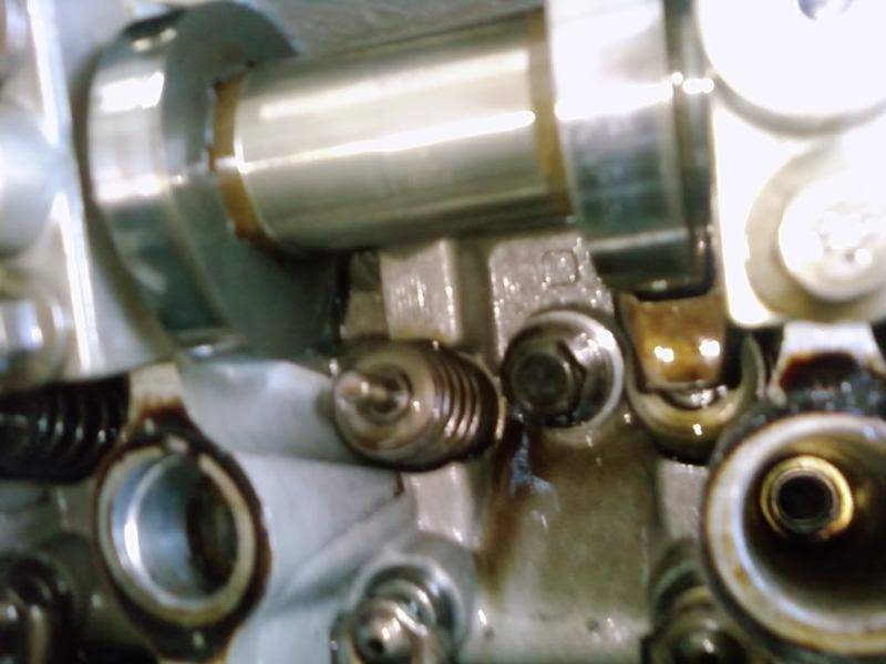

i'd look for a 96 motor, you will have to change the wire harness from the exsiting motor, to the new one, and change the sensors and what not from old to new, but the heads on the 96 will have beehive springs, much better than the 93-95 which were known for valve springs breaking, possibly leading to a rocker arm falling off and having a valve get tagged and bent!! like the one in my shop right now!
