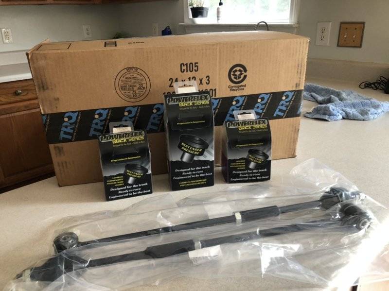

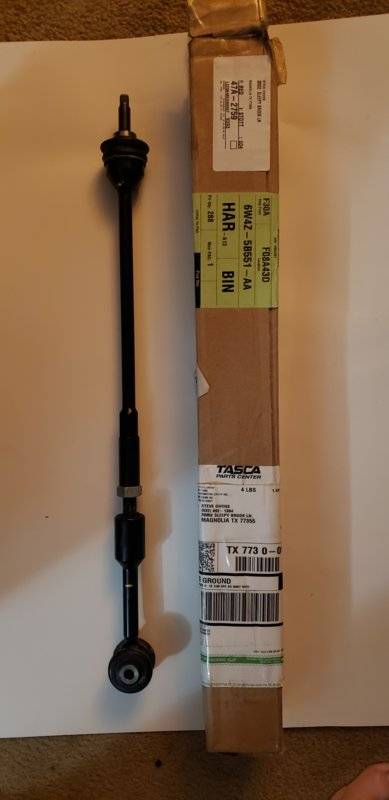

Got some of the parts in today.
Just waiting on rear UCA’s and I need to get some new bolts.
Archangel, you might want to send back those rear toe rods you purchased in the photo. Why, the next pot hole hole you run through will damage to this weakest joint which is the inner ball joint. You may have to pony up to the Ford part in the photo...
If you care to look, check out the outer section with the larger diameter at the length adjustment interface. That is a rubber insulator that can dampen the shock of the deep pots you may run through...

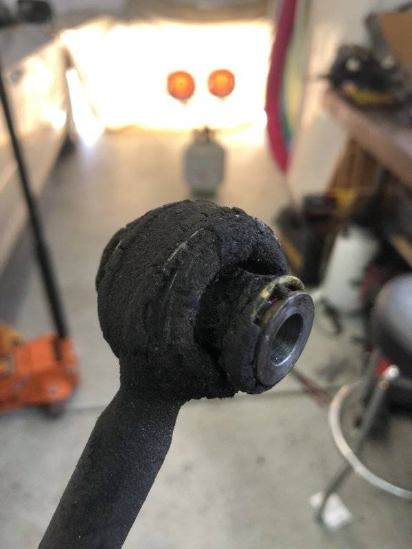

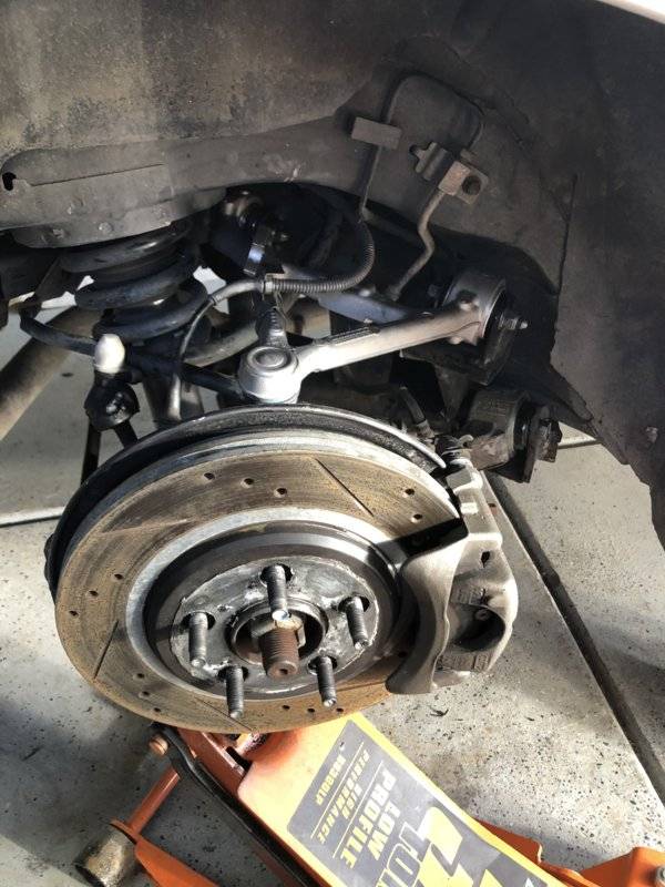

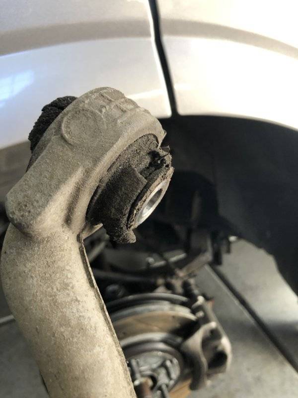

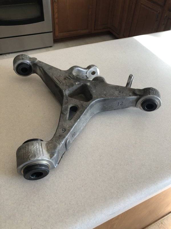

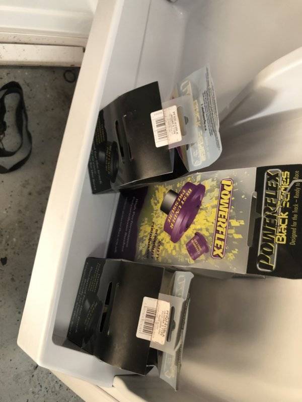

Well, this past Friday and Saturday I went to work on the rear end.
Wasn't too hard of a job, and I was able to take my time. Did one side at a time for each day. While down there taking stuff loose, my sway bar links were worn but not wasted so I went ahead and picked up some from the parts house.
Also note, I put the new bushings in the freezer and took them out one by one when ready to press them in. Not sure how much this helped since the new bushings go in about half way on their own before needing to press them in with tools.

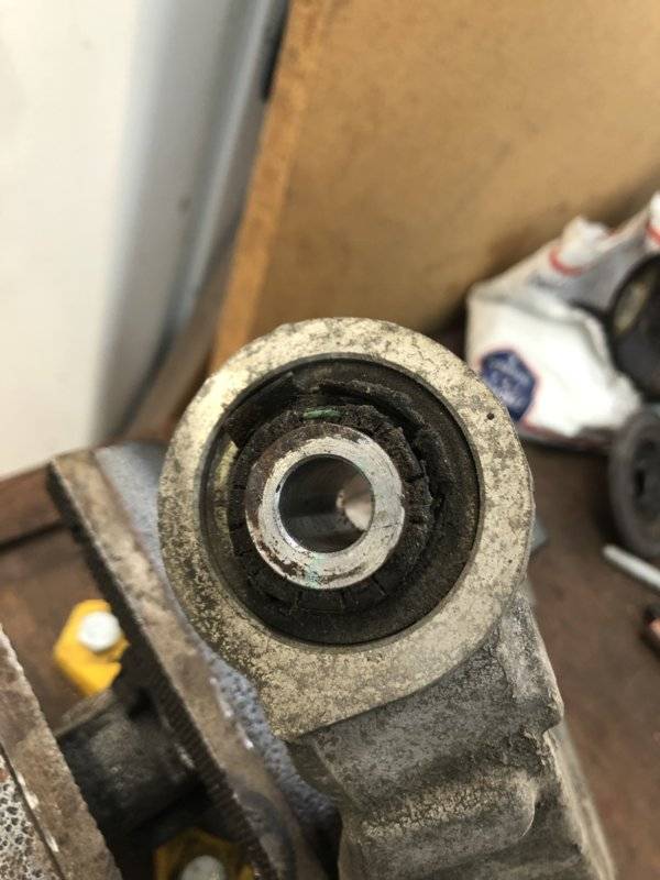

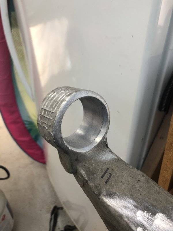

Pretty straight forward, the two smaller LCA bushings, I was able to press out the old and press in the new.
The larger of the three bushings, since I did not have anything that size to use in my improvised press, I had to heat up the outside of the control arm to get the rubber to melt and detach from the metal insert and from there, I used a hacksaw to make a relief cut and a chisel and hammer to carefully pry out the the old inner sleeve. I was able to press the new larger one in.
Replaced both Rear UCA's, tie-rods and sway-bar end links. The sway-bar bushings to my surprise were in good shape.
Since I am the 2nd owner of this vehicle, don't know why I didn't catch this while doing my rear brakes a while back, I found that someone had wrapped the ball joint boots on both Rear UCA's with black electrical tape. Not my style.
Measured the center hub to top of the wheel well (15.5") before working while the vehicle was on the ground. Then after everything was replaced and snugged down, used the floor jack under the knuckle to raise it to 15.5" and then torqued the LCA, UCA, tie rod , lower shock bolts and sway bar end links.
Alignment was off of course, went to see my buddy Ray Ray, who has his own shop and got a 4 wheel alignment done.
All I can say is, WOW! what a difference in the ride. My car now glides almost effortlessly in a straight line and hugs the on/off ramps at 70mph.
Also note, I put the new bushings in the freezer and took them out one by one when ready to press them in. Not sure how much this helped since the new bushings go in about half way on their own before needing to press them in with tools.View attachment 828573687 View attachment 828573688 View attachment 828573689 View attachment 828573690 View attachment 828573691 View attachment 828573692 View attachment 828573693 View attachment 828573694 View attachment 828573695 View attachment 828573696

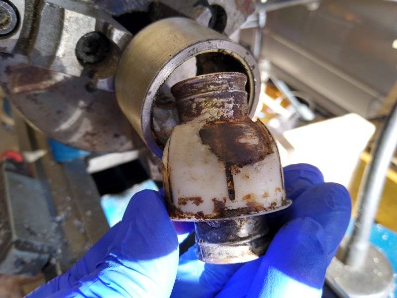

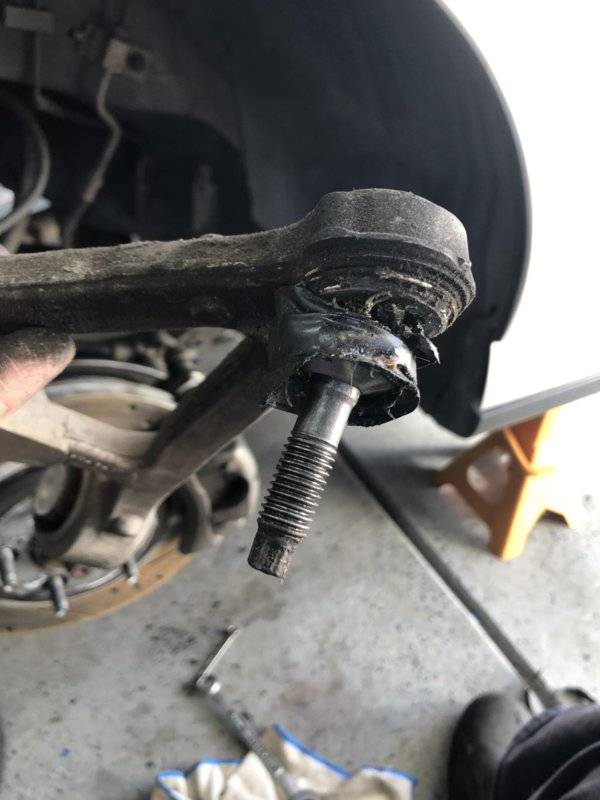

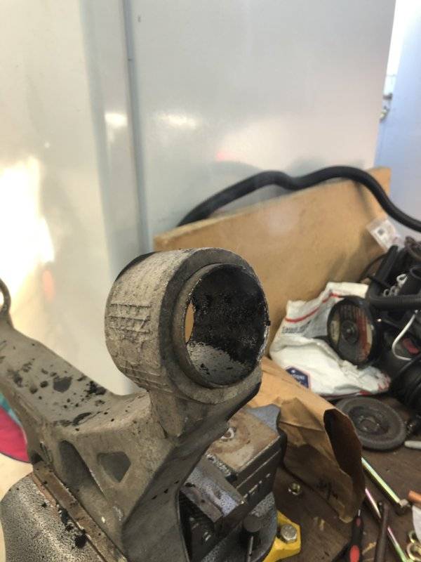

This is the outer rear lower control arm bushing that attaches to the knuckle. Not what I expected since everyone says the original bushings are rubber. I've seen these described as fluid bushings. There are boots and grease inside as well as a ball type fitting and bushing. Does anyone know more about the original bushings? Missing in the picture is the pressed in cap which I turned off on my lathe.
I bought the Moog replacement bushing for this one and I have to say that I am quite disappointed in there sizing. The center section was longer than the original by about .025 and I had to grind it too get it to fit in the knuckle opening. Also the outside diameter was .006 thousands bigger than the original which could explain why people have trouble with the control arm splitting when they press in new bushings.
<snip>
Man, that sucks.
For your question about original sizes,
I wish I could help. I tossed my old bushings a few days after I replaced them.
I hope you can make it all work and not have this turn into an expensive learning experience.
Actually I don't really have any money invested yet. Only about $30 for 2 of the Moog bushings. I do have some time invested because of the pressing in and out of the bushing but I am working on improving my method. I also have some a little time turning the Moog bushing down the .006 and shortening it so it fit but that part I actually enjoyed. I haven't used my lathe in years and I had a lot of fun doing it.

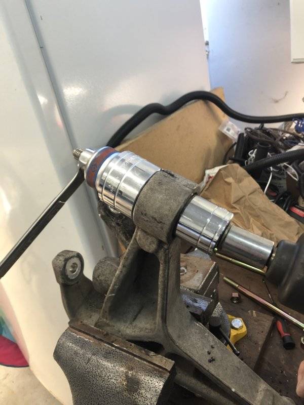

Update: Initially I had trouble finding the right adapters to press out the bushing and after some thin pipe mushroomed on me I decided to take a chance and order the Moog control arm for the 2000-2002 (I have a 2005). My reasoning being the replacement bushings are the same for all years and the Lemforder control arms are the same part for all years as well. Moog does make a different, more expensive arm for the 2005 as well and the other brands do too. Since it was only $95 I figured I would take a chance and if it didn't match just send it back. Of course I usually don't give up easily and went back to trying to press out the bushings. When I found adapters (sockets) that worked I went on to replace the bushing with the Moog bushing as mentioned earlier. By the time I tried to cancel the order I couldn't so I got the replacement control arm I order yesterday. As far as I could tell the new control arm is an exact match. I installed it today and drove on it with no problems. Ordered the other side too.
Cool beans man.
Sockets do come in handy, even when they are not turning a hex head.
