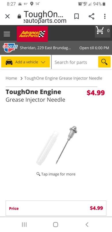

For now get a needle grease attachment and poke the rear control arm rear boots with 8-10 pumps of moly grease. Save 800 USD four new Ford control arms.
Boots? My rear control arms don't have grease boots and surely not enough room for 8-10 pumps of grease. If those arms are indeed worn, replace with new. Safety first, you know? Even if you can get a worn bushing not to squeak, the bushing is still worn and potentially dangerous. Not worth the risk.
Go look at your LS. There are no boots on/over the rear bushings. There's really nowhere to pump grease into. You can at best get some grease onto them.
Use a needle grease attachment. If you feel adventurous take the Energy Suspension tie rod polyurethane boot and fit them over the original boots for long term protection.

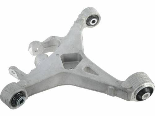

As far as the Rear Upper Control arm, anyone of you had luck replacing the ball joint on the original factory control arm?
It's all one unit
I know that...Power flex sells replacement bushings for the rear uppers to re-furbish them.
I'll go the Power flex bushing route for the rear uppers, only if the ball joint can be removed and replaced. What I'm not going to do is buy new rear uppers and pop out good rubber bushings....Why I'm asking.
You had indicated ball joints which are pressed in the structure
Umm, I think we are talking about the same thing but we are not resonating.
I'm gonna make this an easy question for you Steve.
Look at the picture and if you want, answer the question with a yes or no.
Can the ball joint on the rear upper control arms be removed and replaced with simple tools? The part is circled in red.
Thanks.
Yes, they are aluminum. It is possible to press ball joints in and out of the aluminum arms, if you really know what you are doing. That said, I recommend against trying it. You could warp the arm, or cause it to crack around the joint, later and unexpectedly.
