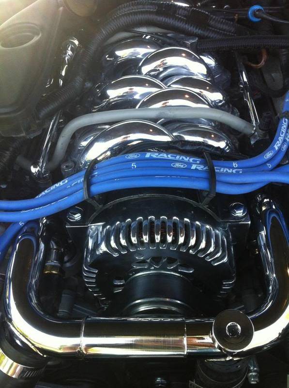

        You can buy a polished one from me:

        What is on that polished tube to keep the rust off?
