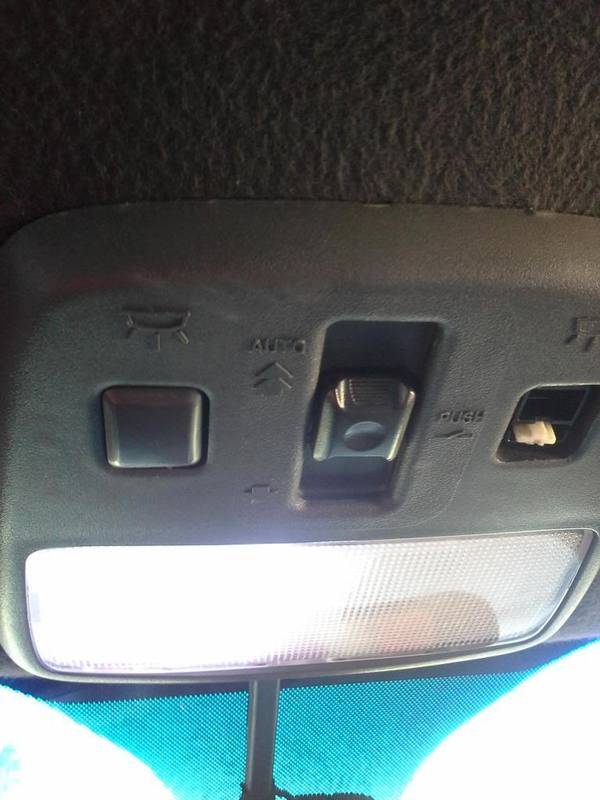

Can someone please help me locate this part on Tasca's website.
Either it's not available or um nit looking in the right place?
I can find it at Ford Parts Giant, but they show it as discontinued (just as Tasca shows the switch as discontinued.)
http://www.fordpartsgiant.com/partlist/console-overhead~2002-lincoln-ls-1952285-1953491-1592424.html
what are you offering? $$ can persuade me to go hunting in my local parts yards...
Dude, seriously, you can't add a dab of glue to that ?
Do you have the loose part of the switch ? JB weld fixes everything!
I would have put glue but i dont have that broken piece the car like that when i bought it.
Im just trying to restore my ls Luckily my local dealer has a few lse parts in stock ;-)

Look on your door sticker. It is the two character code under "INT TR"
Spoonfed? Wtf is that? ... I unlike you cannot simply bust out $90 for a switch.
Dude, let me see if I can help you find one, no promises.
1) Like Joe suggested, what is the interior trim code listed on the label inside the door ?
2) it looks like mine, Trim Code: 4W, charcoal midnight gray or something to that effect ? Trim Code: 4W ?
----EDIT: make that midnight black = 4W
@956LS8, what is the trim code on yours ?

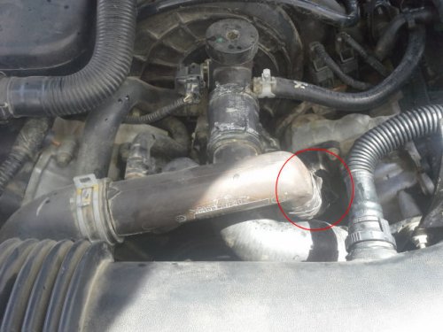

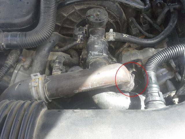

hey listen Bro, what's going on here with this black tape on your Coolant Outlet pipe ?
Please tell me you already addressed this situation, that Outlet pipe is brown in color, supposed to be black,
it's deteriorating and is about to spring a leak any day, surprised it's even holding anything back around that tape.
I don't know the full story on that but just wanted to let you know that it needs attention ASAP, if that's still the condition it's in to date.
The PVC cooling system parts including the degas bottle get brittle and weak as the GEN I ages past 10yrs old, she'd gonna spring a leak for sure.
Just hate to have you on the side of the road with an overheat issue whilst stranded with kids in the car.
If you haven't already, try and see if you can prep some OEM parts for this soon as possible.
not trying to talk you into something you don't need but I know better that the color on that whole outlet tube is a sign of old and weak PVC plastics.
10 bucks says it's pitted with blister marks on the inside of that pipe.
That part has since been replaced as well as the thermostat housing. I went oem on that tube and thanks to the guys who helped me when i was in that situation.
