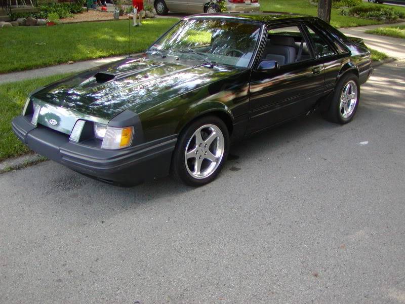

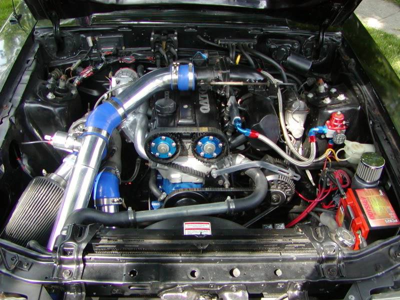

:GotPics: :GotPics: :GotPics: :GotPics: :GotPics: :GotPics:
Of the SVO?
Folder...
SVO%20Build
Currently putting T-Tops in...
Folder...
t%20top%20install
Bob
Hmm... My post with pics of the SVO is gone.... Did I bust a rule? If so, sorry..
Of the SVO?
Folder...
SVO%20Build
Folder...
t%20top%20install
Bob
That is just freakin sick! Great job and sounds like you will be a valued asset here.
That is only the second SVO I have ever seen with that head, just sick.
Very very clean too. Whats the rwhp?
I missed that my posts are being moderated, sorry about the repeat post. /goes and sits off in the corner... Durr....
I had an 85 once. :D
Mark owners just have good taste and like the idea of a fast car that very few others have yet still blends. Be noticed without standing out. :D

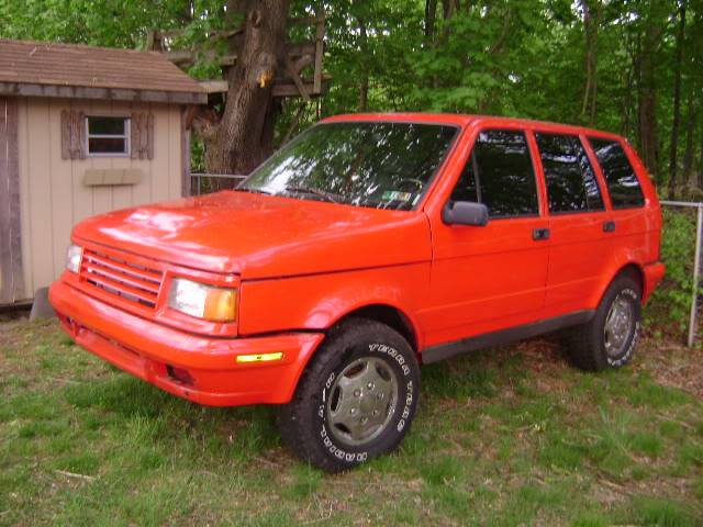

Oh, crap. Is your next car a Catera? LMAO
My Laforza left me with no support. 1 of like 300 in the U.S.
