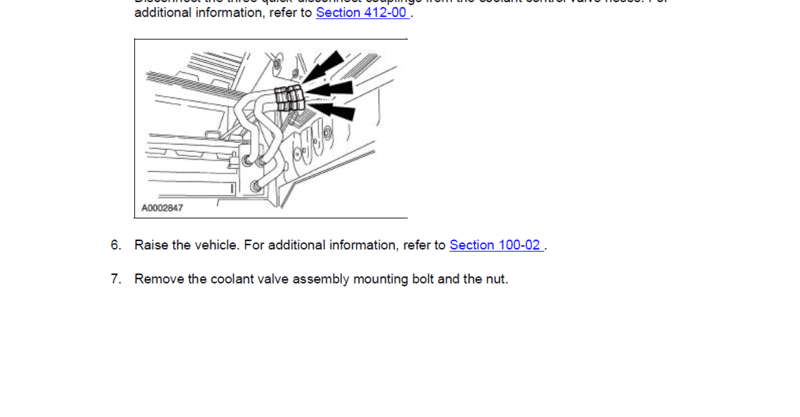

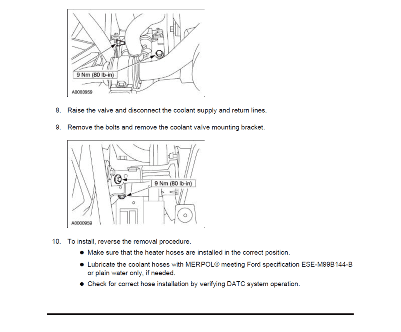

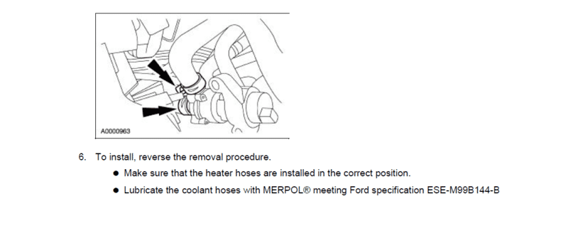

    So i have a 2001 Lincoln LS with the 3.9 v8. Well i recently figured out that i have to change the heater control valve. Ive already purchased the replacement heater control valve. i cant find much information on how to really change it. Ive tried to youtube it. But all im finding is people replaceing them on the v6 models. any info or insight would be greatly appriciated!!
