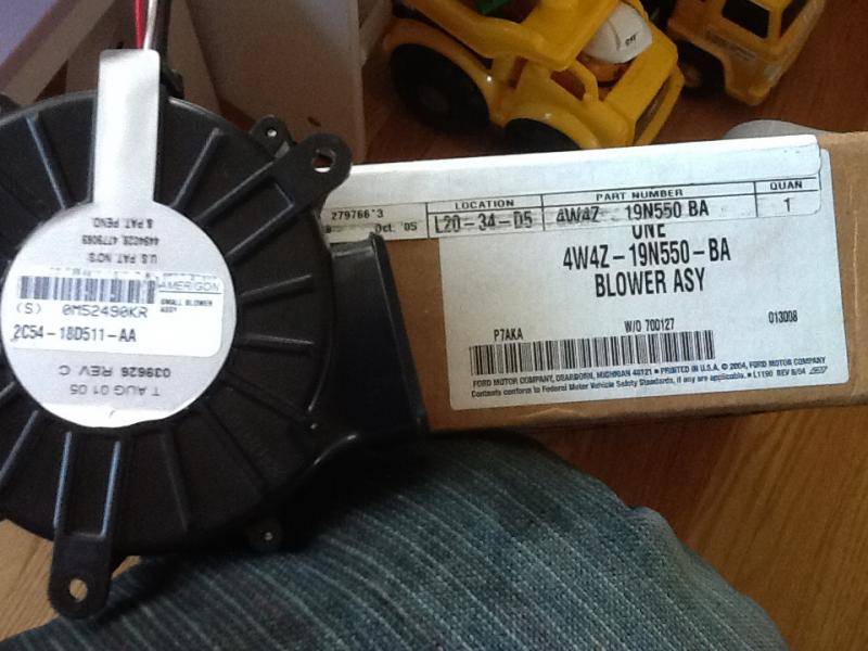

Hello joegr,
The replacement fan assembly complete came from a Ford dealer.
It looked new but now I am not sure?
I think I got a new used bad fan??
