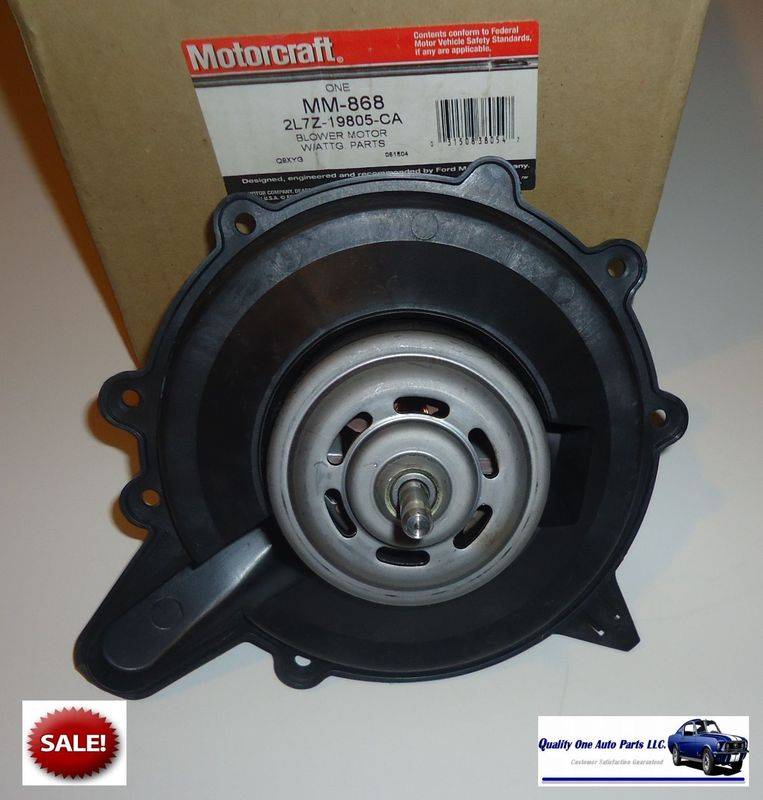

Does the heated/cooled seat blower motor look like this? I too posted a thread a while back but never got around to fixing it. Glad this post came back up.

Where did you get the part? I'm looking at 19N550B which is $276 msrp through Ford....
