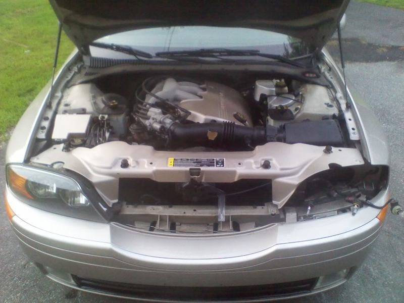

One is one out, little shot of the engine bay, nothing big...

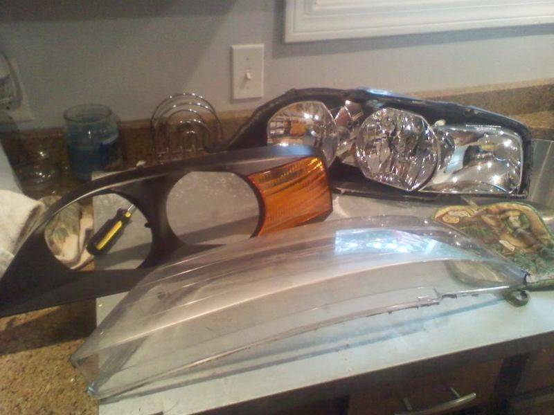

after 5 min in the oven on 280 and with a little work, the headlights were separated.

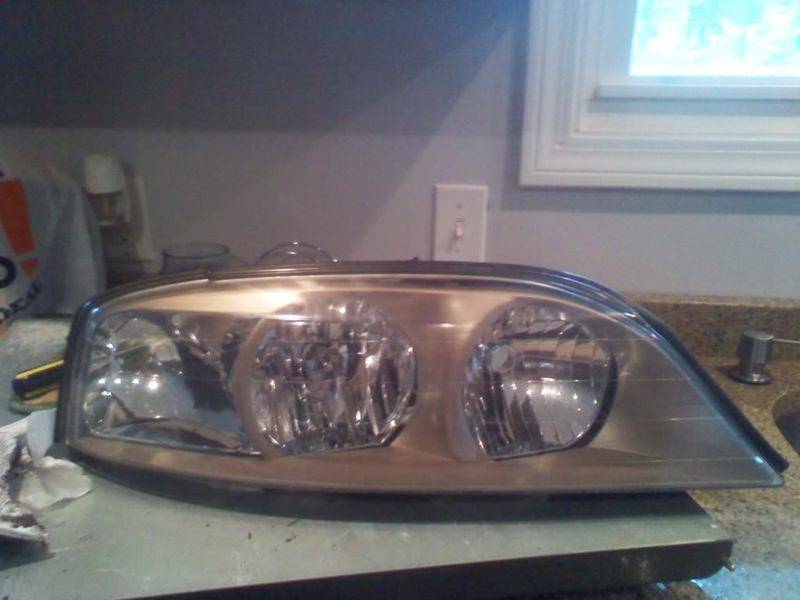

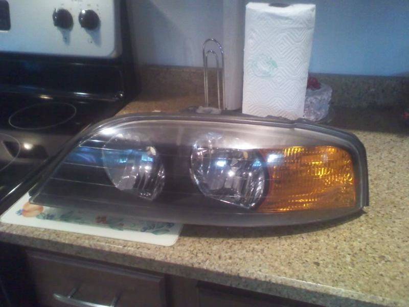

afters clearing the turn signal and painting the bezel I re-assembled the headlight by reheating it, setting back in its place, and re sealed it using black RVT sealant...

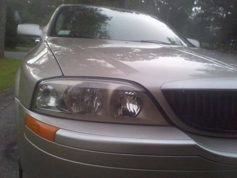

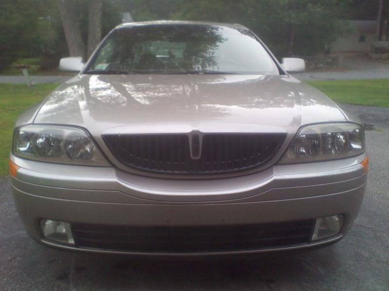

and both done and on the car....the bezels are a little darker then the color of the car, but over all Im happy with the outcome.
