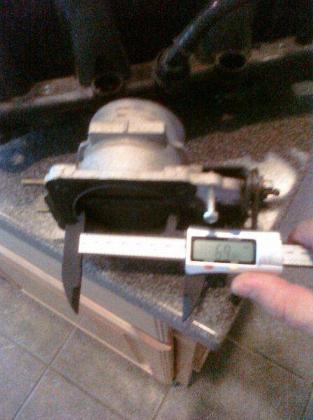

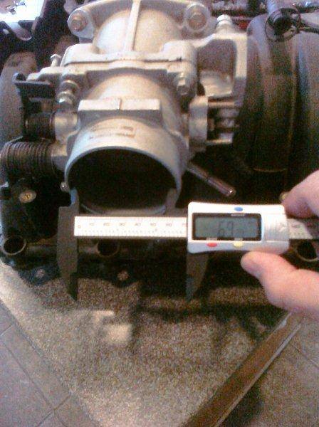

Here's a stock Gen1...
So bigger TB will result on what exactly ?? I though the biggest (the vacuum can handle) the better..
It has alot to do with engine needs, intake manifold design and intake track design. You want to allow as much air in as the engine can pull, but at the fastest velocity you can get. velocity helps torque. otherwise ever car would just have a big TB on it, and manage the plate with a progressive linkage.
