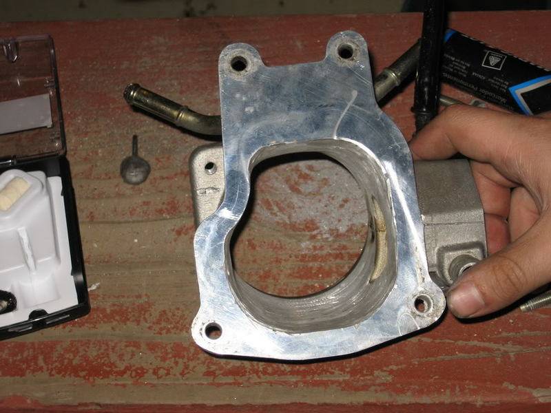

Well I got my stock TB off, the plenum type deal behind it doesnt look to be too restrictive at all so Im thinking of just figuring out some kind of adapter for the Mustang twin blade to that stock front plenum. I ran out of light tonight so more to come tomorrow, also Im gonna measure the baldes and compare. Gonna have to do a TB coolant bypass as well the stang doesnt have nipples for the hoses.

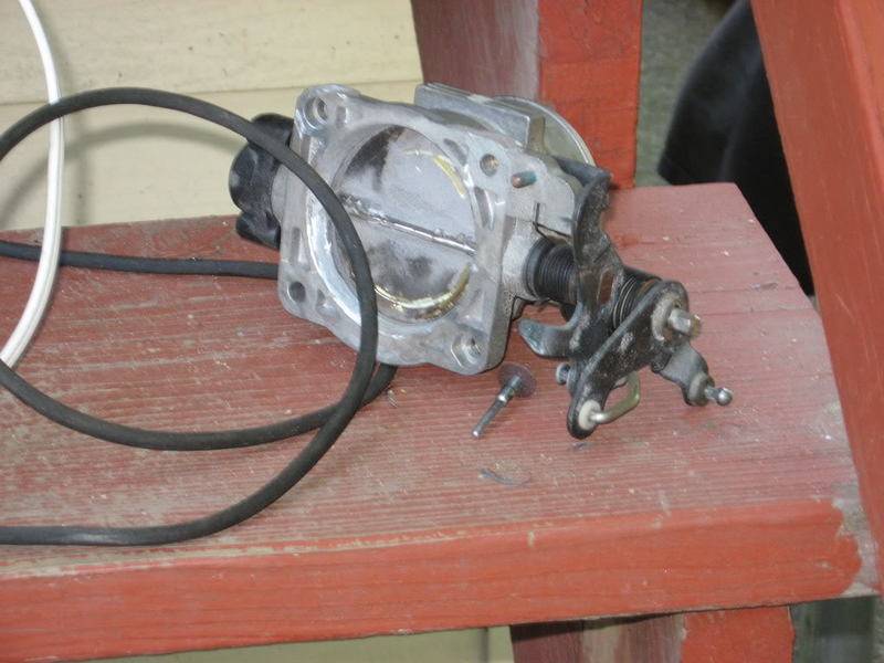

i took off the TB and just cleaned it and lubed it up... it had enough gunk on it to qualify for EPA funding. I was having trouble getting a few cables off of the plenum so I decided I'd save it for another day because I have work tomorrow and its too nice to be sitting screaming at my car, just gonna wash and cruise it instead. But I alread had my dremel out so I shaved down the bolts on the TB plate :) every mm helps right? Did you say your idle went a little rougher after boreing(?) the TB?

Anywho.. Obviously Ive been slacking on this twin blade throttle body situation. Ive come to terns that this might be harder than I originally thought, I have to make a complete plenum device/piece in order to use the Mustang throttle body and getting it to mount in the same location is gonna be a complete PITA.. What Im looking at now rather is/should be a lot simpler. The 4.0 V6 BBK throttle bodies also use the same connectors as the Gen2 3.9's.. The twin blade is going on Ebay and Im going to purchase the 70mm monoblade BBK throttle body which should be a direct bolt on.. More to follow.. Oh also Im going up to Stainless Works this weekend if everything goes as planned to check out the entire headers back system they have..
