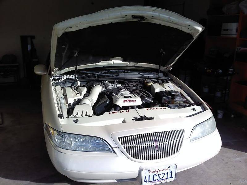

What Jamie said (BAD97LSC). BTW I love what you have done in the engine compartment. Very nice color scheme IMO.

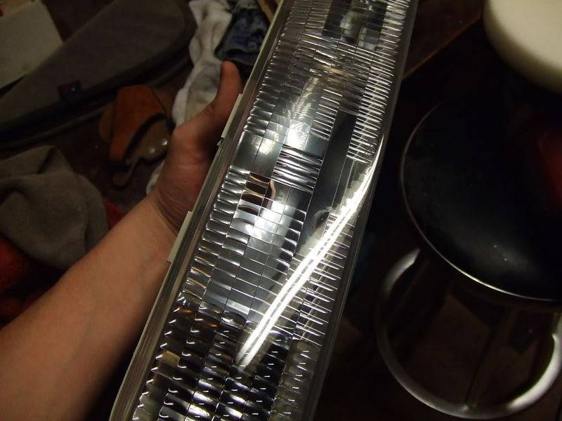

heres what i did, i used 1500 grit to wet sand. then used 2000 to wet sand. then used meguiars fine cutting compound with a rotary buffer to buff out the head light. (foam pad, a wool pad would be ideal i just didnt have one) then switch over to meguiars swirl remover and use a foam pad to buff out.
heres the results i got.

and Mark0101 thanks for the compliment on the engine compartment
