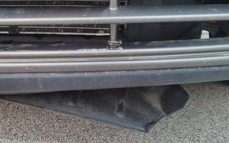

Now I just have to get the damage to my bumper fixed *sigh* (dealer is paying for the fix):
