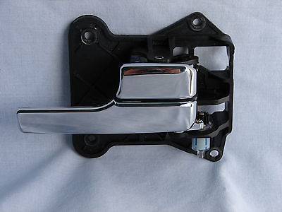

Bottom lever is the door handle, top lever is the lock. Are you sure you've ever used this car?
LOL! When I went outside and looked (before you posted that picture) I had a "doh" moment. No explanation for my brain fart - wasn't even drinking yesterday......

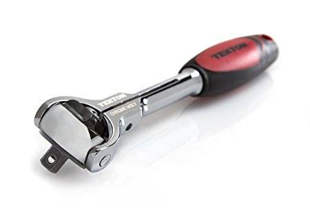

The hardest parts of the solenoid replacement was getting the 10mm bolt out of the solenoid wiring harness, and getting the pan to drop. On the pan there's a lip that hangs on the crossmember so it has to come down. The problem on the wiring harness is the bolt screws in from the top and goes straight down. There's a special tool you can get for it, but what I did was use a 1 inch hole saw to drill a hole through the floor panel large enough to get at the bolt with a regular wrench. Two holes side by side, then nipped the bit in the middle to make a slot to work through. To seal I used a stainless steel plate I picked up from Ace Hardware with steel rivets to hold it in place. I also used body sealer (comes in a tube, need a caulking gun) to make a waterproof seal. This was after spending a lot of time on my back trying to get a wrench on it from underneath including slicing a wrench down to try and get it in there. Problem is the trans was really designed for the larger trans tunnel of the Explorer, and the LS tunnel wraps a lot closer around it so there just isn't any room to get up in there without the special tool. Once the wiring harness is disconnected, the pan is dropped and the filter is removed, nothing else has to come off to replace the solenoid pack. Slides out, slides back in. I don't recall but there may be a couple of bolts holding it in.
When you get the pan off you'll see why it works to start the car, let it warm up, then open the drain plug and let it drain fluid till it stops coming out the drain plug. There is a 2-3 inch long tube on top of the drain plug and when the fluid level is correct, the fluid level is at the top of that tube. There is also a plug on the passenger side of the trans, facing the back of the car, to the passenger side of the driveshaft where you can put fluid in. If you don't have a pump you can do what I did, which was to use tubing and the pointy top of a Lucas fuel additive bottle to push the fluid in. The top of the Lucas bottle almost screws onto the top of a trans fluid bottle, then you can squeeze it in.
Or, you can cut down a cheap ratchet to fit. This, IMHO, is easier that cutting a hole in your car.
You know, I couldn't see how to get a ratchet in there. Even a cheap ratchet is larger than the wrench I'd cut down. I tried a 1/4 inch breaker bar. I even tried putting some money into one of these.
Perhaps you could post a pic showing what you used then. Won't help me since I won't be doing it again but perhaps the OP could copy it if it'll save cutting the hole.

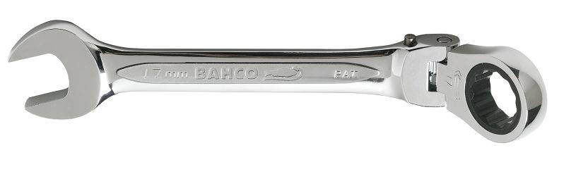

I did it years and years ago from underneath with a shorty-wrench. I believe this would work.......
