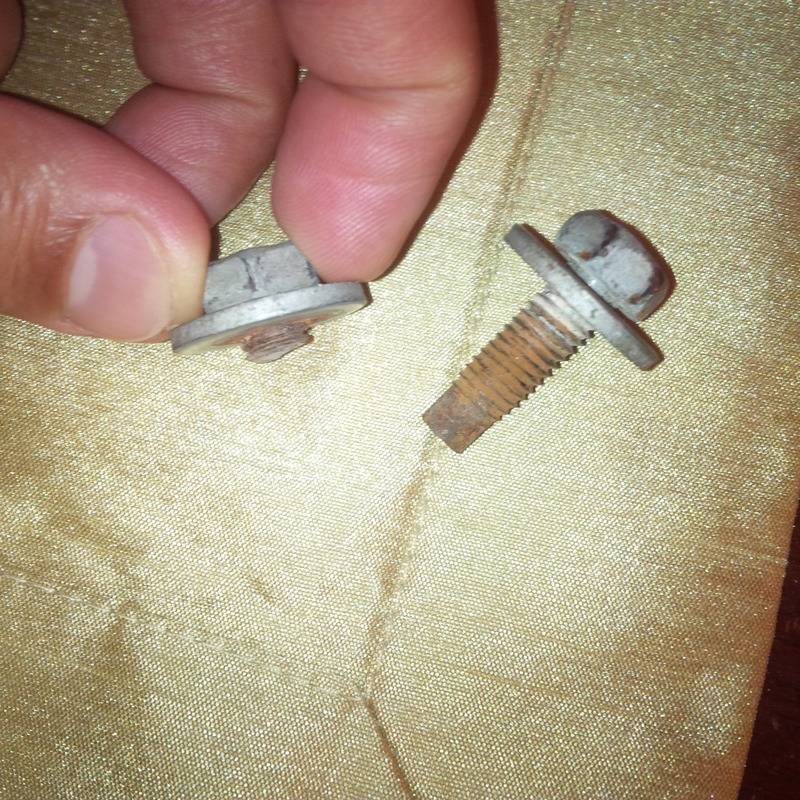

I got everything in the PCM area in the engine bay out tonight to have access to the module except that the middle bolt for the engine strut brace broke off right below the bolt head so have to figure out how to get the rest of the bolt out and see if my local dealer has one. I can put it back together temporarily with the other bolts though.

I mentioned that the very middle bolt for the factory strut brace sheared/broke while removing it (sheared off at the head - rusted). I've never had to remove a broken off or sheared bolt before. is there a trick to remove this?

On the broken bolt, an easy out will work. Those bolts are large enough that an easy out will be easy to use. On the replacement bolt, this is a hidden bolt so you can replace with any bolt of the correct length and pitch. It'll be a lot cheaper to pick one up at the hardware store than the dealer. The dealer bolt can be as high as 10 bucks for one.

I don't know where you are, but put duct tape over the computer connectors on the wiring harness. Very important, you don't want water in there at all. While the computer is gone you can use an Easy-Out to drill that broken bolt out. You're going to want all the bolts to put the computer back, otherwise you might get mystery water leaks in the passenger floorpan after hitting large puddles.
Thanks, will do. The one stud on the bracket broke about half way so I should be able to reinstall/tighten up both sides as long as I can find another nut that fits....or another bracket if I can find one quickly for a good price.
