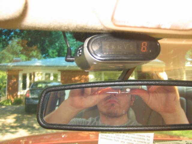

Hardwired the pork detector....

no more having to turn the Joe Bolton notifier on and off separate of the key stroke
sits higher up on the windshield so it's not as noticeable to thieves and the PoPo...clean mod
Why didn't you tuck the coil cord up in the headliner? Doesn't look vey clean IMO, but your LS is sexy as hell.
Tuck that wiring up behind the headliner by the windshield and then it'll be clean. I like it, though :D
ehh..i would cut the coiled part off and get some wire and take it to the fuse box..tuck it through the headliner, run it through the panels..ect..mine only has about 1 " of wire showing...its a mark 8 but im sure u could do it to your ls. it only took me about 25 min to hardwire it..
my responce took alittle to long...i dont know how much give the ls's headliners have..thats alot of wire to tuck..
There's plenty of room above the headliner, and the forward edge is easy to pull down enough to stuff the wire in.

also, i'm not a ls guy but where did you hardwire it to cutter?
took the crimps out of the connector going into the mirror, cut them off and recrimped new ones with both the detector and power leads together

I would also say to tuck the cord away. If you want to move it just pull it out, it's not like it will be permanently stuck there. What brand is that?

yeah, the headliner isn't the issue, its the getting the suction cups to stick to the dot pattern. I think its even worse if you have a replacement windshield in the car. It can take a while to find a spot in between the visor and rear view mirror that wont let it fall down.

the detector is a Passport 8500..saved me quite a few duckets in speeding tickets

+ 5 on tucking the wire, or getting the passport hardwire kit that just has a straight wire
sbcaprice305: you will want to be careful putting the detector up too far, if it is behind the blue tint, it will reduce your forward range, and if it is mounted too high the headliner will block the rear facing sensor completely
