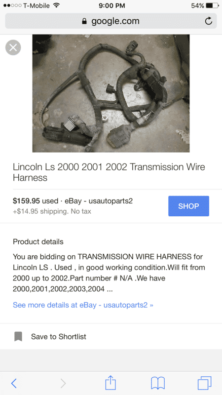

To be honest the car has just been sitting there waiting to be fixed. I would like to remove the whole trans to pcm harness and recheck my wiring(fingers crossed) and try again. The computer was fixed by a software update. Any advise on removal of the transmission harness? I don't fully know what is connected to it but I do know that it is separate from the main harness and looks like this.
As I said before,,, you should be able to trace it back to the previous harness connection. Yeah,,, its tight above the trans but with some "finesse" you should be able to figure out where the harness connection on the tranny actually terminates. I haven't had to worry about this on the LS,,, but someone else on this forum shoud be able to tell you what you need to know, (actually I think they already hinted at this).

Obviously... a boneyard might be a good place, (inexpensive), to source the harness. You know what to look for when it comes to that. :oops: Not sure if the harness needs to be year specific or not.

Wow. That's surprising! The only yard with an LS in my area has a V6 which has a different harness. It is still worth it to stop by the yard though and rob some parts. I was able to remove the harness without even touching the exhaust or transmission. I repaired and soldered the wires and shrink wrapped the connections. The harness looks like it is brand new and is wrapped as such. The part that had messsd me up last week is that the signal return wire goes through some sort of resister with three other wires and comes out on the other end as a different color. Now I know that the wiring is correct. Now it's just a warranty solenoid pack.
