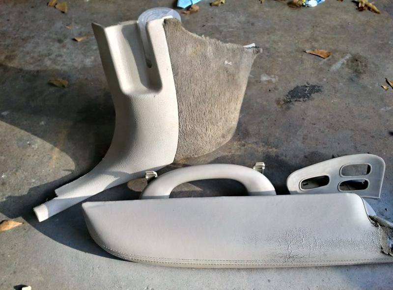

OK I know this an old thread but this is what popped up when using "search". I have a 97 with light grey interior and a dark gray dash. I need to touch up some trim pieces and was wondering what to use for both the light and dark grey. I've had luck with SEM products in the past but I need to know which greys to try.

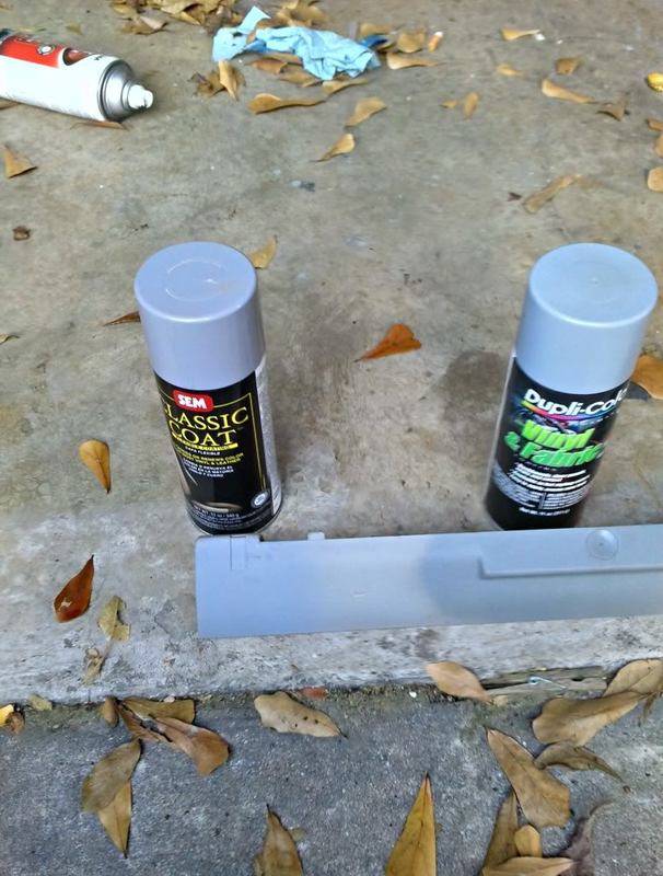

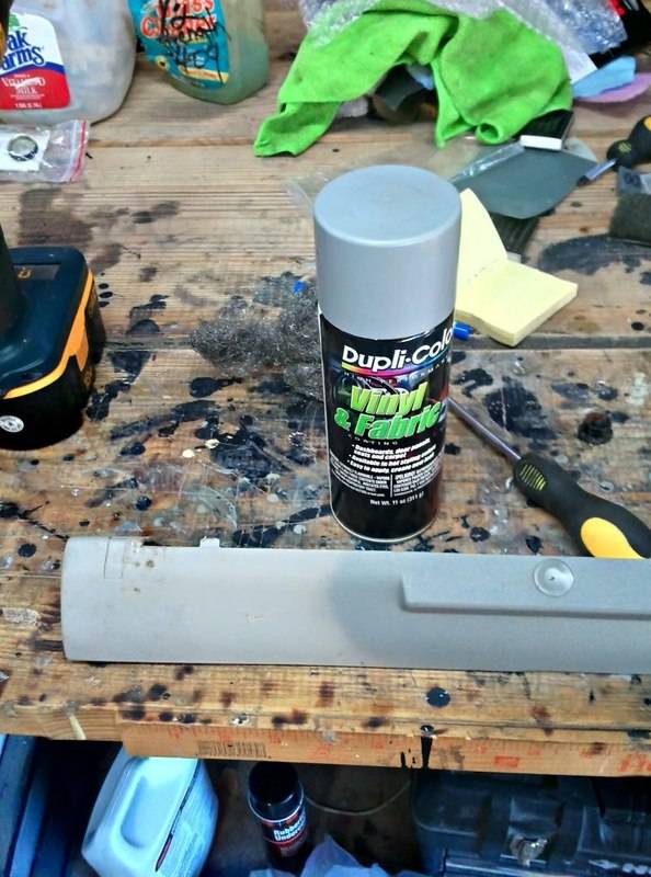

This is the Duplicolor grey Vinyl and Fabric (never found a duplicolor that was called 'dye')

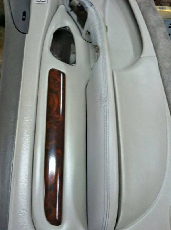

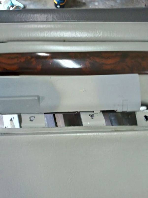

I gave it one more shot. The door handle is complete with 2 coats. Nothing else is painted.
This is with 1 coat of adhesion promoter and a long vigorous shake of the can.
The corner is painted forward about 3 inches...

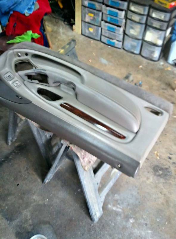

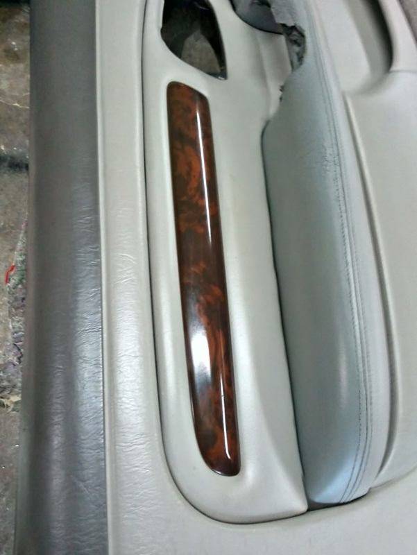

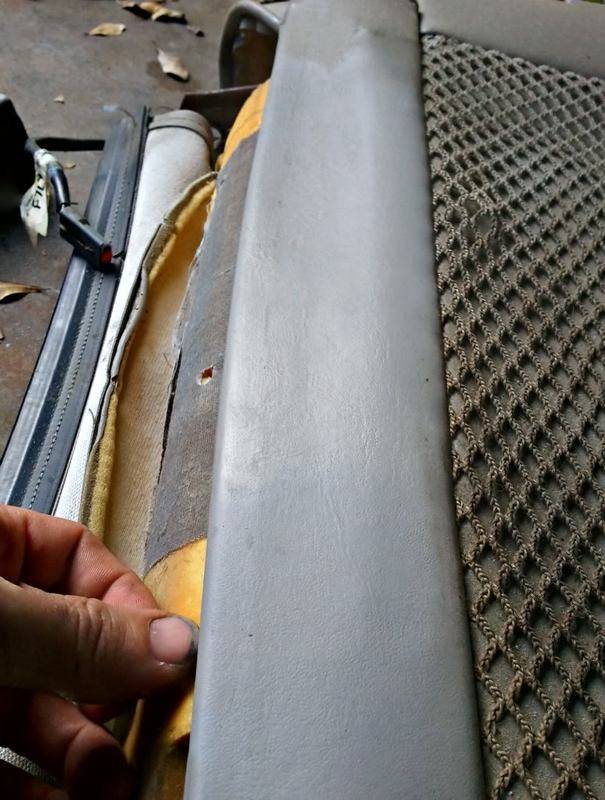

This is the SEM stuff.

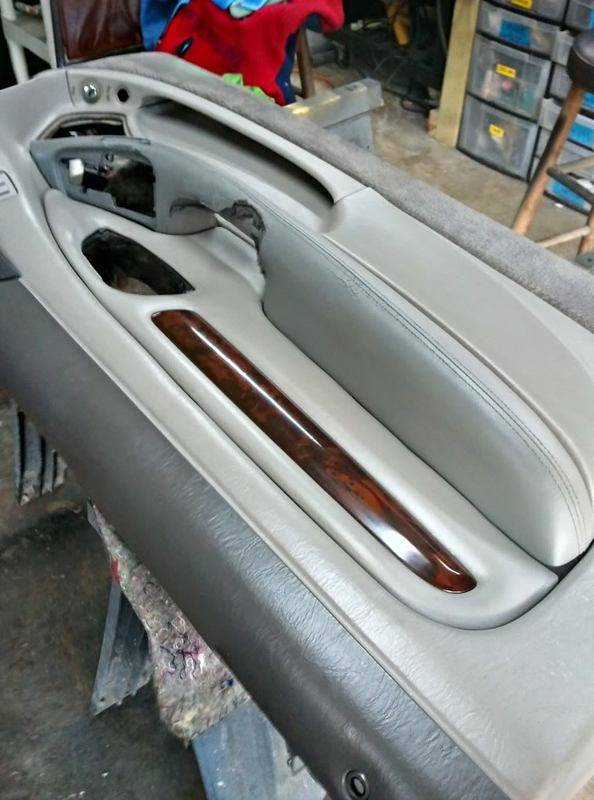

another light and a heavy coat
Then I put the Duplicolor coat on light .. then heavy to see what it looked like.
While these colors are close I think for an exact match you will need to find something different or have it made.
