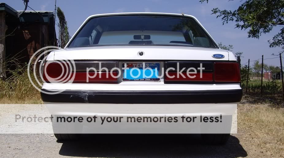

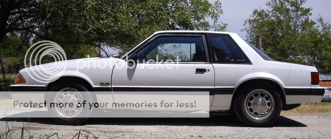

1990 Notch 5.0 with AOD. About 187k on it. Picked it up last week. Ran pretty good but needed some work. Fixed all the vac lines, new cap and rotor, new fuel filter and a stock air box on the way. She runs purrrrfect now. Had crappy lowering springs so I put the stockers back on. Also replaced the seals and clutch on the AC and now it blows ice cold. Steering was spooky and needed inner and outer tie rods plus the sway bar links were missing. Much nicer now.
Only mods are Flowbastards and an Accel coil. Completly stock otherwise. :cool:
Shes loud, obnoxious, not fast, poor gas mileage, little rough, rides worse than a truck and the seat hurts my back but for some reason I like this old beast. :)

Its for sale now. i was waiting for the stock air box to show up before I put it online.
Car aint perfect by any means. Its a strong runner but it does have issues.
Couple dozen hail dings on the top side.
Rad support is a little mangled on bottom but seems to hold everything straight.
Door seals are shot.
Trans dont like 4th when at running temp. Works great for the first 6-7 minutes of driving but when the car gets to temp and if you stop or make the trans downshift it never tries to go back into 4th. I know the band is good cause 4th dont slip at all and I was lucky hitting the highway quickly today so it stayed in OD for 50+ miles. I know the TV cable is adjusted properly too. My best guess is the 3-4 shift valve sticks when warm. Trans fluid is nice and pink though.
Other then that I put 150+ miles on it today with no issues. AC was freezing cold, engine never got to the half way temp mark, oil pressure is solid, trans uses the first 3 gears well ( :lol: ), exhaust sounds killer but loud.
Engine always fires up instantly and runs very smooth. Have yet to see a drop of any fluids leaking too. Oil pan is dry.
Never got nearly as many thumbs up in the Mark as this car gets. Everyone loves it. Every other Mustang on the highway would race to get up next to me and check it out. Always with a wave and a big smile. :)
Interior is in spectacular shape.
Gonna put it on craigslist for $3800.
