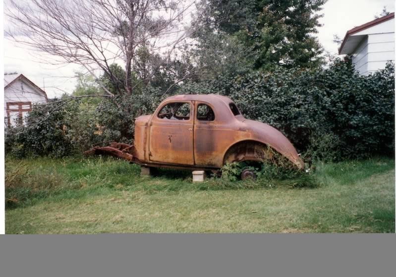

That is a cool slide show, its neat he kept that car.
Cool dad! he must have loved that slide show.
My dad always made hot rods, then sold them.
I remember them but that's about it.
This was his last build he finished up in his 70s
We kept this car.
before
after
that's a sweet ride, what engine is in there, looks like an early hemi?
