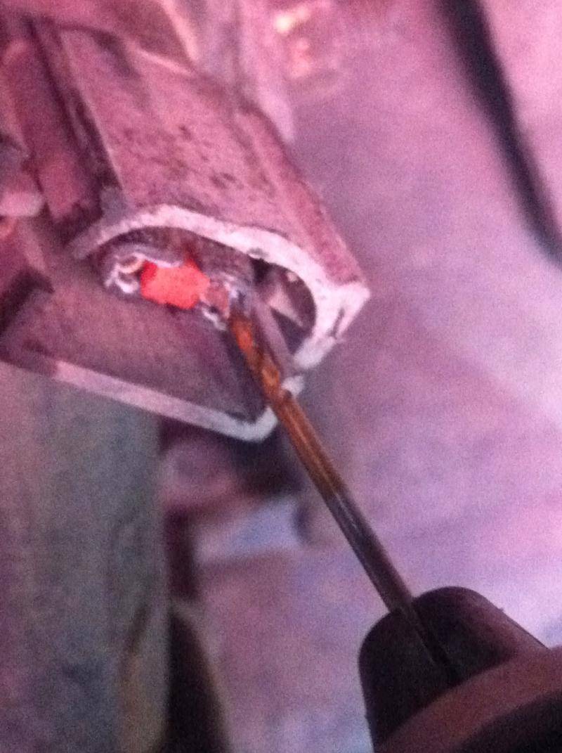

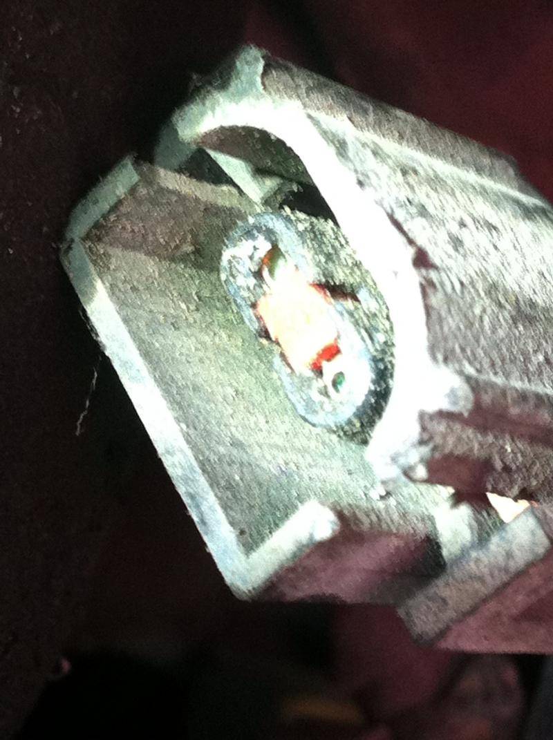

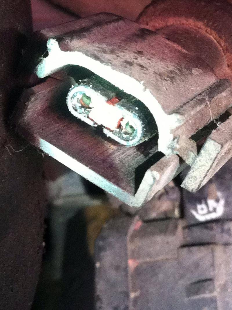

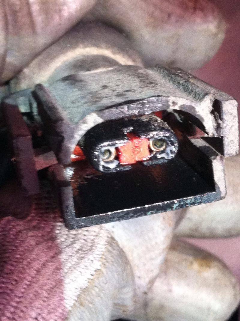

The airspring solenoid was indeed the problem.
Here's how I fixed it. I detached the airspring solenoid from the front passenger side since that side did not seem to be venting properly. The air ride sensor had to be moved out of the way to get to the solenoid so I only unsnapped the upper mount of the sensor. All this was done with the tire and wheel intact while I raised the car from the K-member. There is enough room there to work once the car was in the air.
I needed to test to see if the solenoid was opening so I fed 12 volts to the contacts using a back-up car battery and some alligator clips. I had to make sure my connections were good several times because I could not get any activity with the solenoid.
With my volt meter probes at the end of the live wires, I was getting 12.69 volts. Reconnected the wires again to the solenoid and nothing. Not even a click. That told me what I suspected all along.....corrosion at the contacts......voltage was not getting through the solenoid....preventing the airspring to vent.
Here you see how bad the corrosion got.
Glad you got it figured out, and it wasn't anything major. If you need a connector or solenoid let me know.
Wow, that thing looks really ruff! glad you got it fixed. i just went through a month & a half long marathon on my air ride system, before i finally got it fixed this past weekend. they can be tough sometimes to diagnose.
This corrosion was the primary reason why my compressor relay went out. At least I know my compressor is not dead yet and I don't have to swap out my Gen1 compressor to a Gen2. Haha, it may keep going til it sees its 20th birthday.
I tried to scrape off as much of the calcium off the pin contacts on the solenoid. The barrels in the male plug seemed to be caked with the stuff so I used a small 1/16" drill bit to clean and auger the crud out of the plug.
Now with good metal to metal contact with the solenoid pins, I sprayed both electrical connections with anti-corrosion spray to keep corrosion from coming back.
I re-tested the bag solenoid with 12 volts through its contacts and heard a familiar click followed by a long hiss.
So there it is. Fixed!
Eventually, I will look into all my airspring solenoid connections for corrosion abatement. With this repair, there was much improvement with the way the car handles. Unlike before, she now rides firmer and maneuvers better, stays level at all speeds and parks level now too. No more squatting overnight. All because the computer is now able to receive proper sensor data.
Over a period of time, we all just become complacent with little maintenance we can do, that we just accept how our air ride deteriorates in time.
Don't let this happen to yours if you're still on air. Check for corrosion. It may save you grief, anguish and frustration later, when you're on the road.
