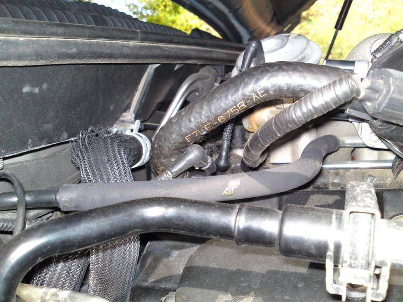

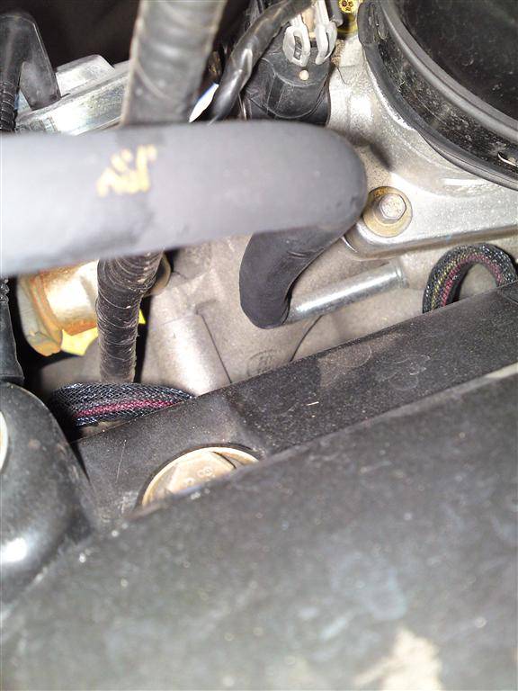

So what I need to see is if on the stock intake if the EVAP line runs to the intake hose or if it runs to the plenum. If someone could please look by where their fuel lines come in to the engine bay you will see a 3/8" hard vac line come up that connects to the intake. I need to know where on the intake it hooks.
