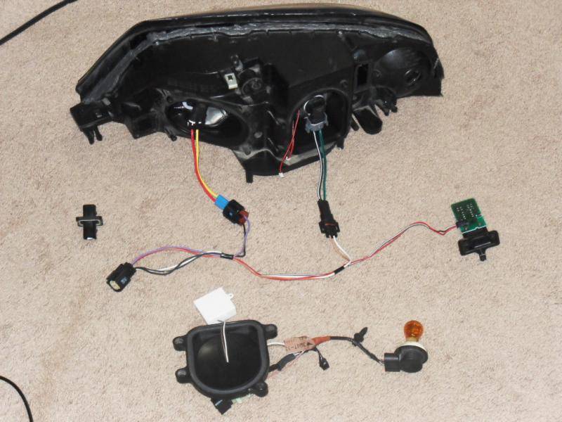

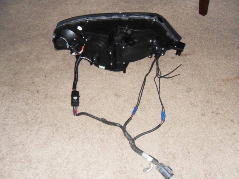

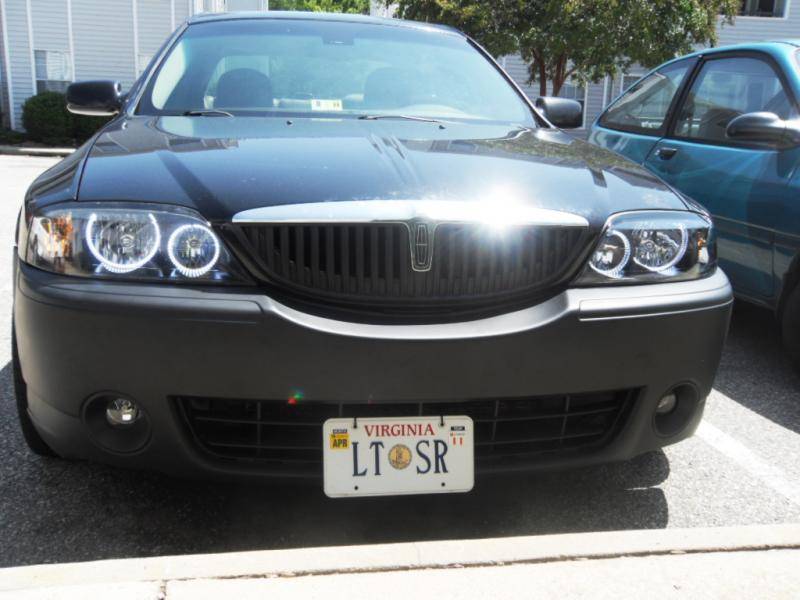

You can always trace the wires in the gen 2 light then match up the harness wires. Took me 20 minutes to do it that way.

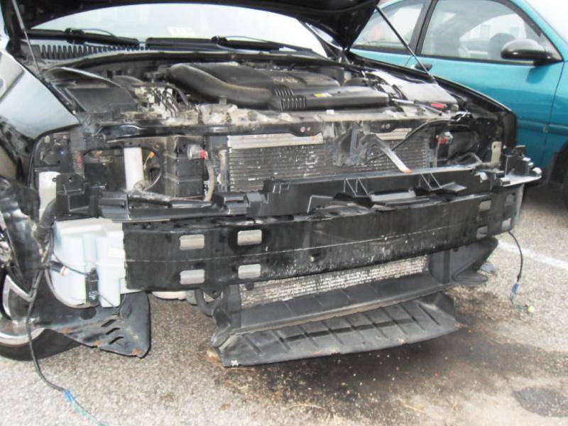

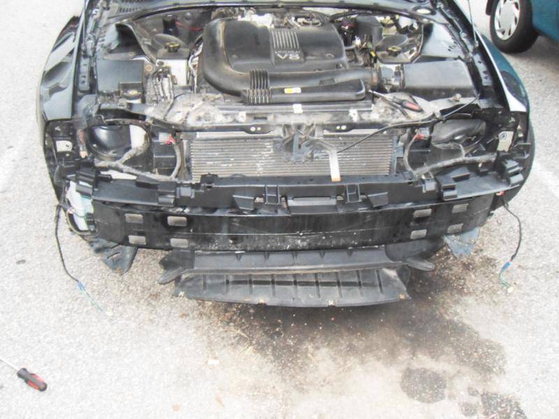

I installed the 03-06 headlights on my 00 back in 2006. I bought a new front crash bar specific to the 03-06 and then bought the HID 03-06 headlights. I already had an aftermarket hid kit installed, so I had to do nothing different with my wiring. The only thing is the small LED running lights do not illuminate.
I still have to hook up my LEDs. I'm just going to connect them to the wiring for the old gen 1 side markers.
