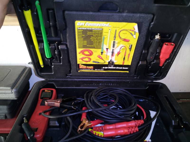

Got one of these???
Anyone who plans on doing anything electrical more than once should make their life easier and go get
